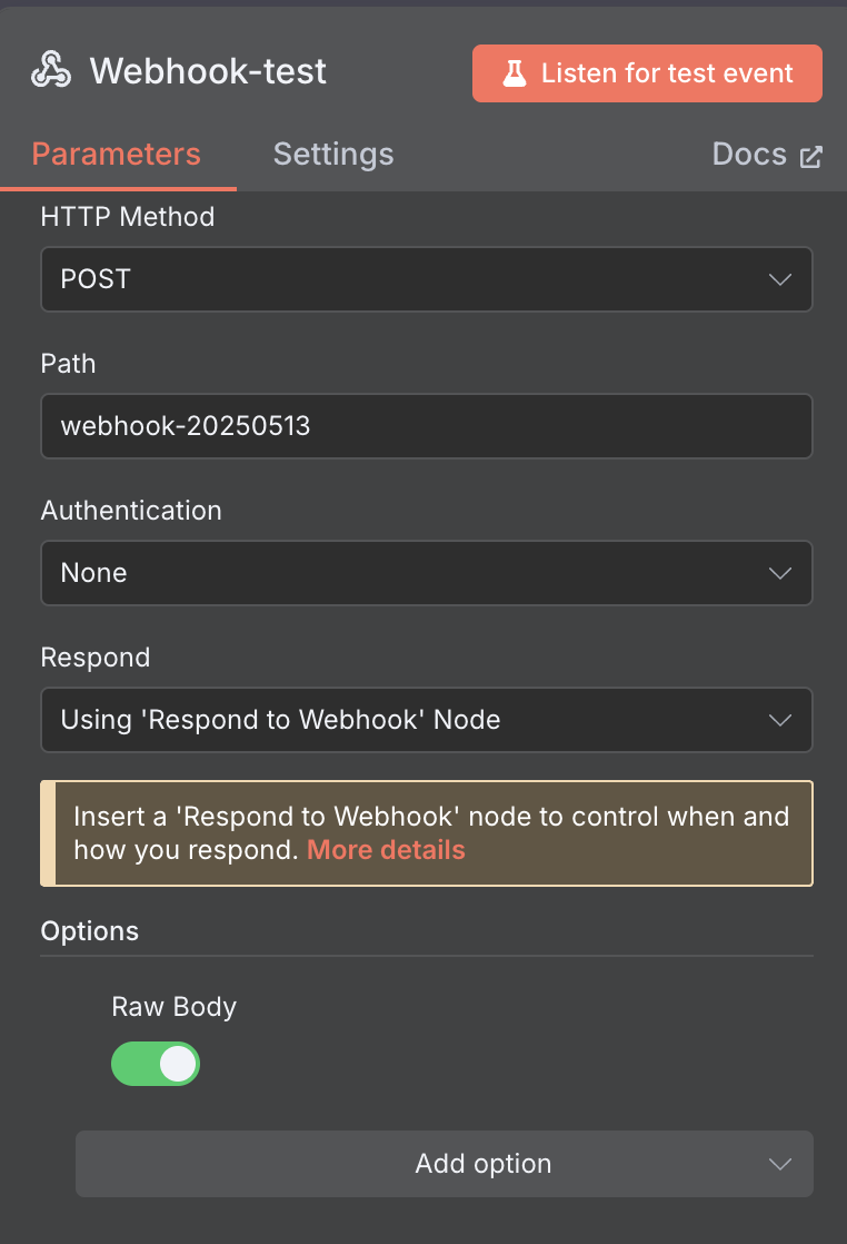

You have to check “Raw Body” in the options of the incoming webhook
