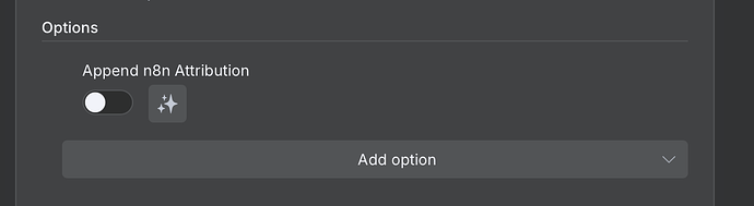

Some nodes that append an n8n element, like forms and email, you have to disable the n8n attribution option. If you do not see that option on-screen:
  1. Open the node and select the Add option pick list.
  2. Select the Append n8n Attribution option (or similar)
  3. A toggle switch will appear and will show as enabled. Select the toggle switch to disable it. See attached.
Now, when you run the workflow, you should not see the attribution.
