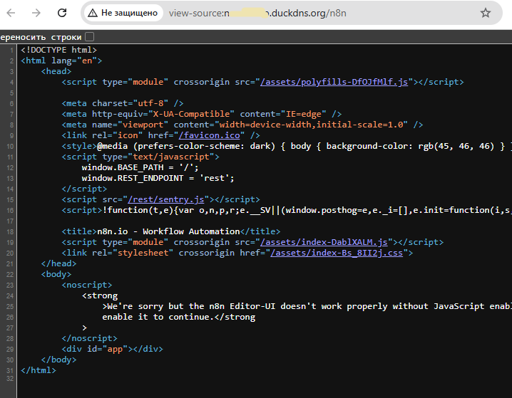

nero-auto.duckdns.org
Page source code:
view-source:https://nero-auto.duckdns.org/
The instance with the Alias ​​did not start.
nero-auto.duckdns.org/n8n/
Page source code:
view-source:https://nero-auto.duckdns.org/n8n/
These pages are correct. All paths are correct. But the page with the alias does not work…
What am I doing wrong?
Thanks.

No. It doesn’t work.
I still get a black empty page.
This page has the code:
That is, the server still gives me something to the browser!
