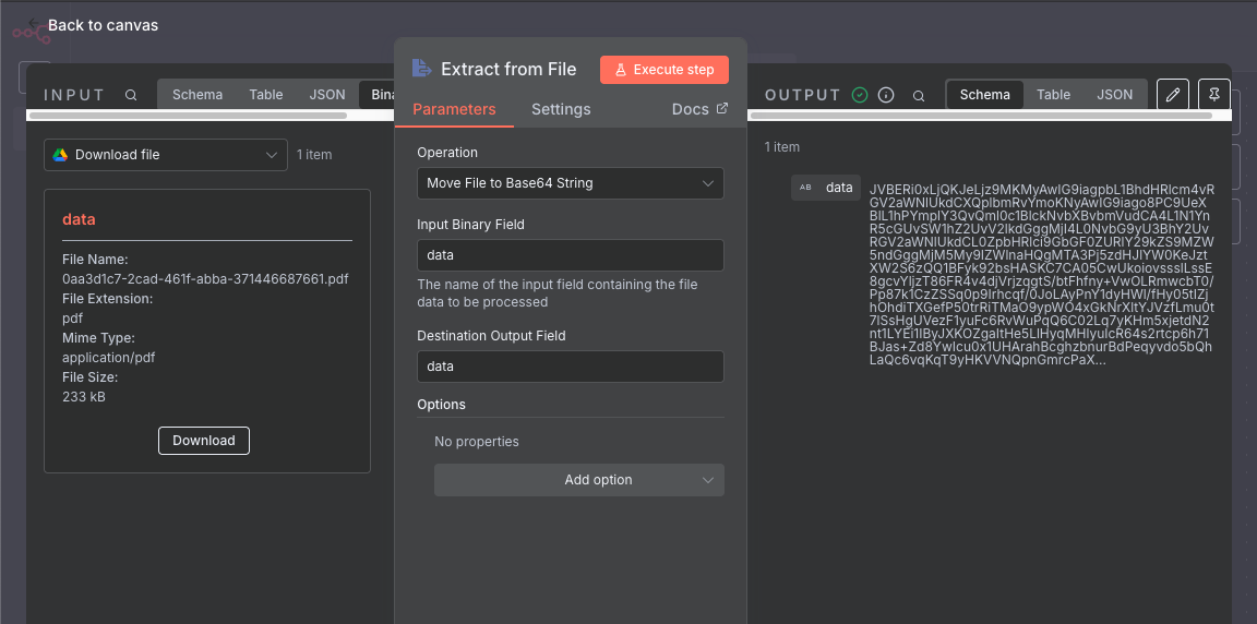

Try this:

This is how you can turn pdf binary to a base64 string.
