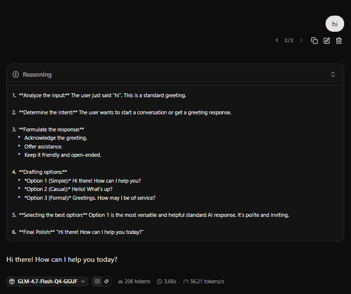

expected (llama-server):

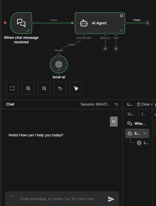

I would like to see the reasoning output similar to how llama-server shows it, but I can’t find an option in n8n to enable it. Is it not possible?
workflow
actual: “Hello! How can I help you today?”
expected: “”"
  1. Analyze the input: The user just said “hi”. This is a standard greeting.
  2. Determine the intent: The user wants to start a conversation or get a greeting response.
  3. Formulate the response:
    • Acknowledge the greeting.
    • Offer assistance.
    • Keep it friendly and open-ended.
  4. Drafting options:
    • Option 1 (Simple): Hi there! How can I help you?
    • Option 2 (Casual): Hello! What’s up?
    • Option 3 (Formal): Greetings. How may I be of service?
  5. Selecting the best option: Option 1 is the most versatile and helpful standard AI response. It’s polite and inviting.
  6. Final Polish: “Hi there! How can I help you today?”
  • n8n version: 2.4.6
  • n8n EXECUTIONS_PROCESS setting (default: own, main): queue
  • Operating system: ubuntu

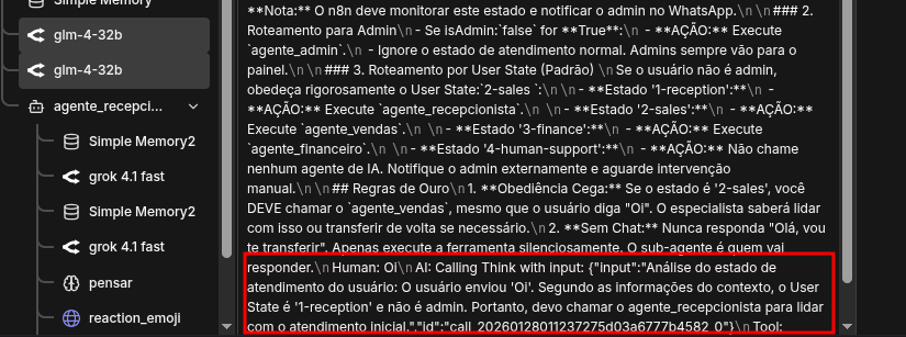

I think it depends on your model and AI provider… Does the AI model you picked have advanced thinking by default? But you can also use the tool “think” and you can see the model thinking inside it. Thinking does not go to output by default here though. (which is good). I can also see all tool calls it makes at the end of the Ai inputs.
