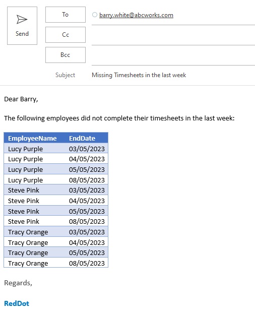

Thanks here is some example input data and the expected output.
I want to get the method right as I have loads of these SQL queries I run which give similar formatted data which needs to be split by a certain column to email that person.
Input coming from SQL Server:
Individual email output:
This looks great, I think this is the one I will have a go.
