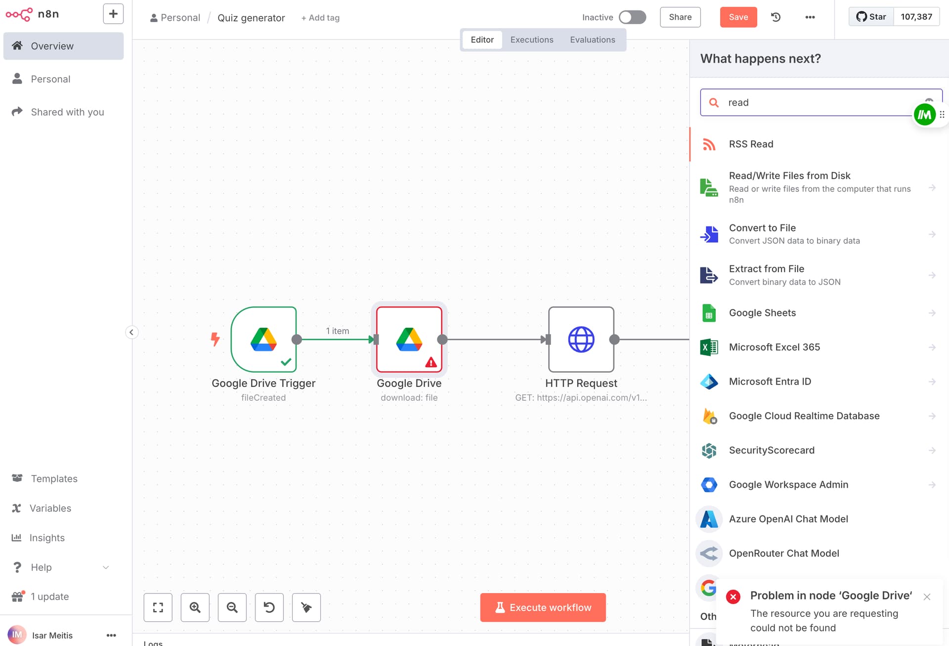

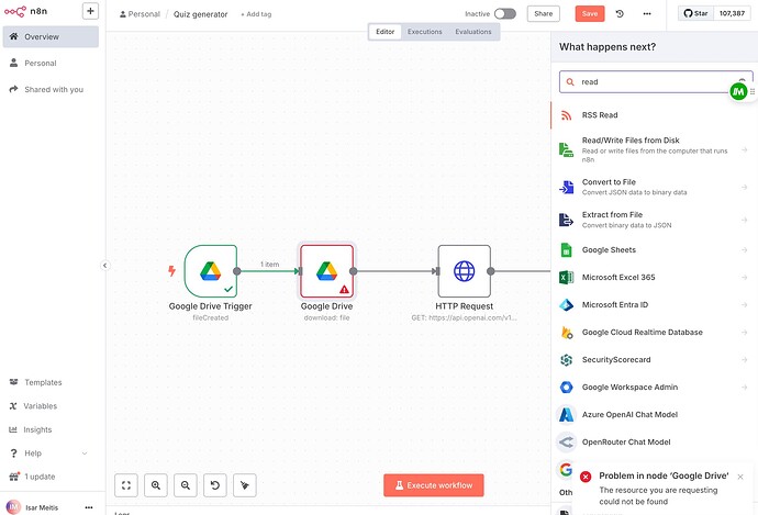

Thank you. I am still struggling with the “Read Binary File” which I assume is now called "
Read/Write Files from Disk" . Do yo by any chance have a template that has all the steps and/or a loom video that shows how to set it up.
