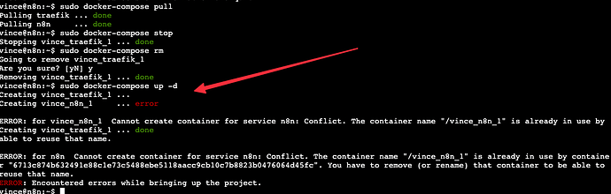

I found the yml file. Then went to correct directory. Then most of the sudo worked but the last one.
The problem is in restarting it.
On the “docker” command issue:
I did not manage to restart the container… either (when I went via docker command) due to the section below, Tried to run your command in a few different ways but kept getting some errors. So the n8n app is still down, as I have stopped it and removed it but wont restart…
CleanShot 2022-04-22 at 10.48.42
Looks like for both I am having issue restarting, and it feels like I might have messed it up the first time by using the docker command.
So that error is a bit trickier, Docker thinks the container is already being used. I would use the docker rm command to remove the existing container and you should be good to go from there assuming you have the volumes set you shouldn’t lose any data.
Running the docker rm for that specific container ID actually worked!
Thanks @Jon and @samaritan - Everything is now up to date, and back working. :pray:
