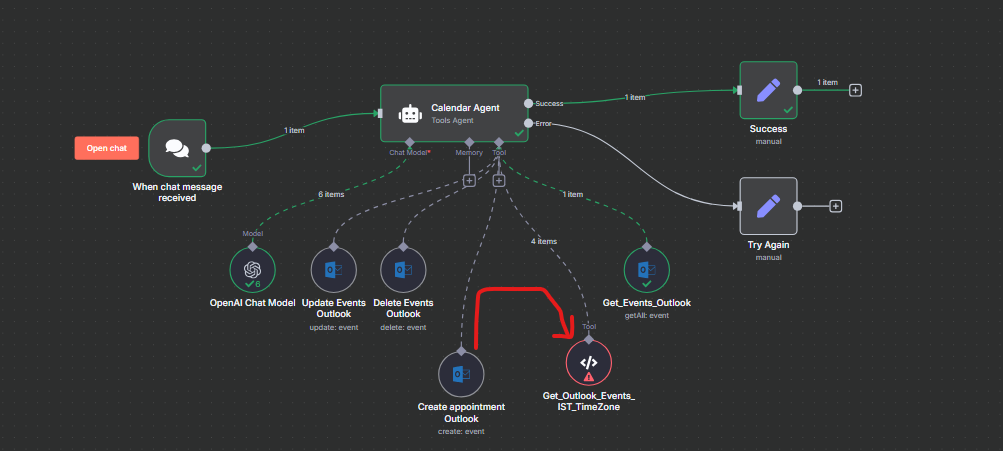

I’m using the latest version of n8n (self-hosted via Docker). I have an AI Agent node that outputs data in UTC timezone, and I want to convert this datetime data to IST inside a Code node.
The AI tool outputs data like this:
  "query": "[{\"start\":{\"dateTime\":\"2025-04-17T04:30:00Z\"},\"end\":{\"dateTime\":\"2025-04-17T05:30:00Z\"}}]"
I want to access this query value inside the Code node, parse it, convert the UTC times to IST, and output the modified result.

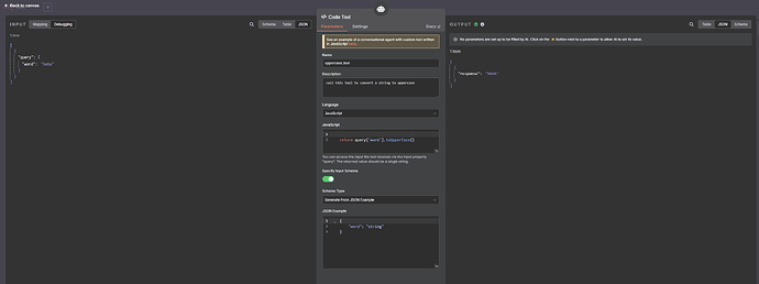

  • Running n8n via (Docker):
In the Code node, you don’t use {{$fromAI('json')}} — that syntax is for expression editor, not JavaScript.
Instead, inside the Code node you access data using: const inputData = $input.item.json;
if you’re looping through multiple items: const items = $input.all();
An arbitrary example:
to access your data i think it would be something like
let temp = JSON.parse(query)
let endTime = temp[0]['end']
the conversion is up to you
i am using the AI agnet nodes .i am using AI agent what ever i got the input OUPUT FROM outlook get event . i need to pass in a code module. i already tried you way . it is not working.
