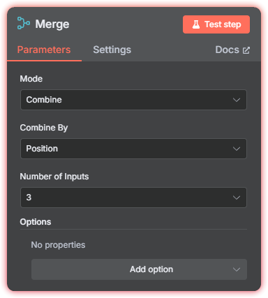

You can try the Merge with Combine Mode and Combine By Position:

Hi Mohamed,
Thanks for the swift reply. In this scenario it has the same behaviour as Append which isn’t quite what I was hoping for. The Code node was written to pull specific fields from each JSON and bring it together in one JSON. Being able to deal with the inputs individually was a way to make it cleaner.
Looks like I either have a code node for each HTTP node and merge them after or merge before and parse it out.
Thanks for your help
