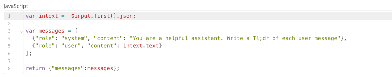

I guess it’s a mix between this:

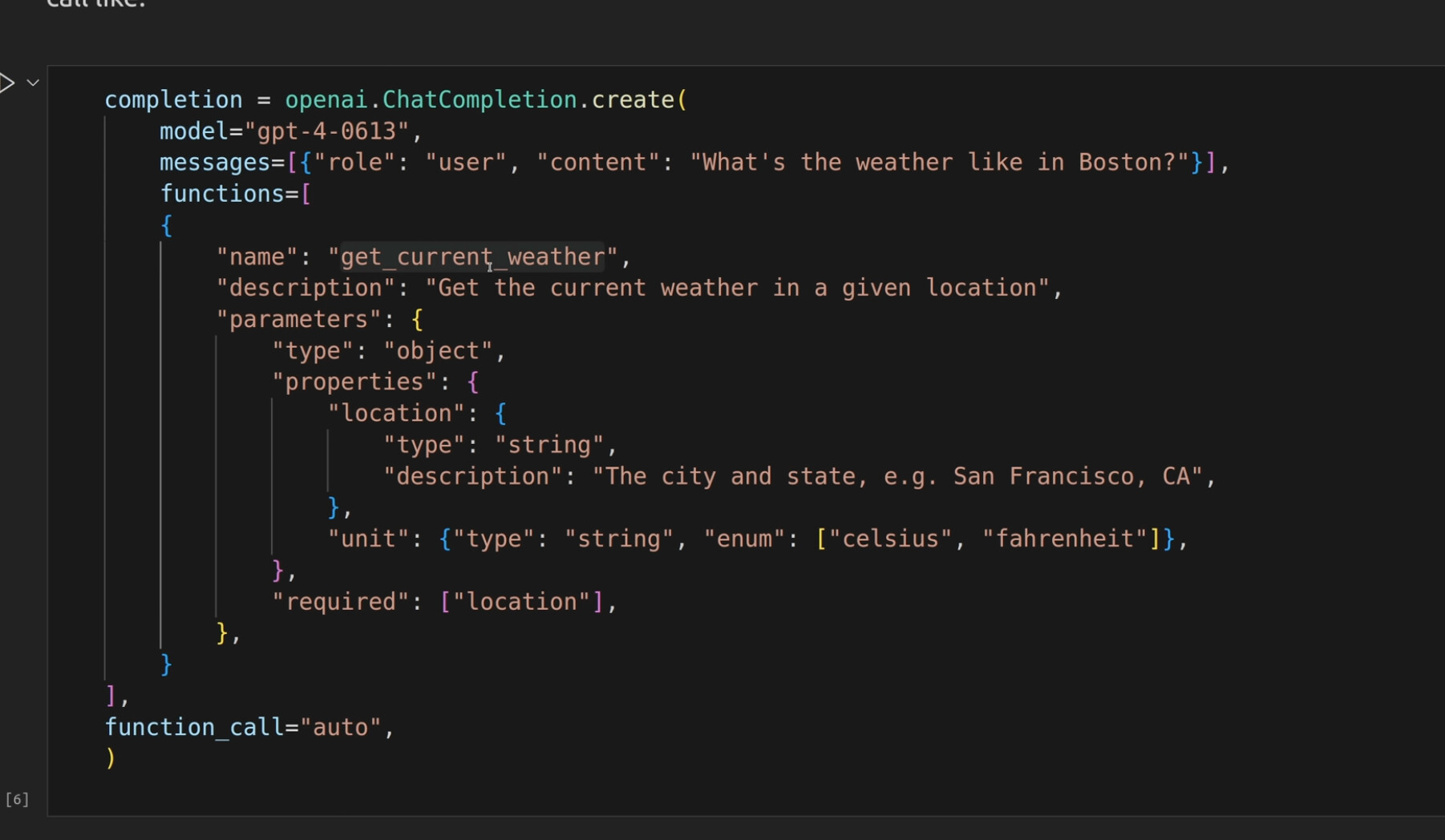

And this:
But yea- i could just ask chat gpt to blend it together… :joy:
@Jon example above is gpt4 but i guess 3.5 is more feasable.
Hey @ManyQuestions,
It will be the same for both really the only change would be the model but don’t forget it would need to be javascript and you would be sending the http request from the code node so you would need to add some imports.
