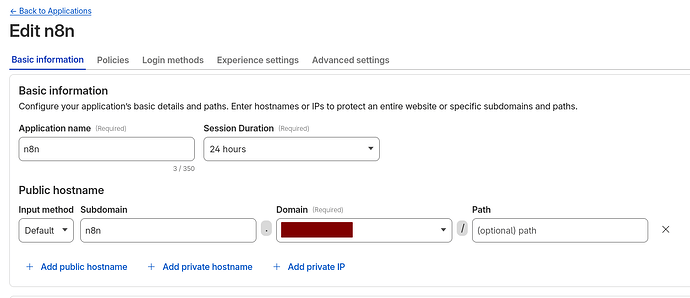

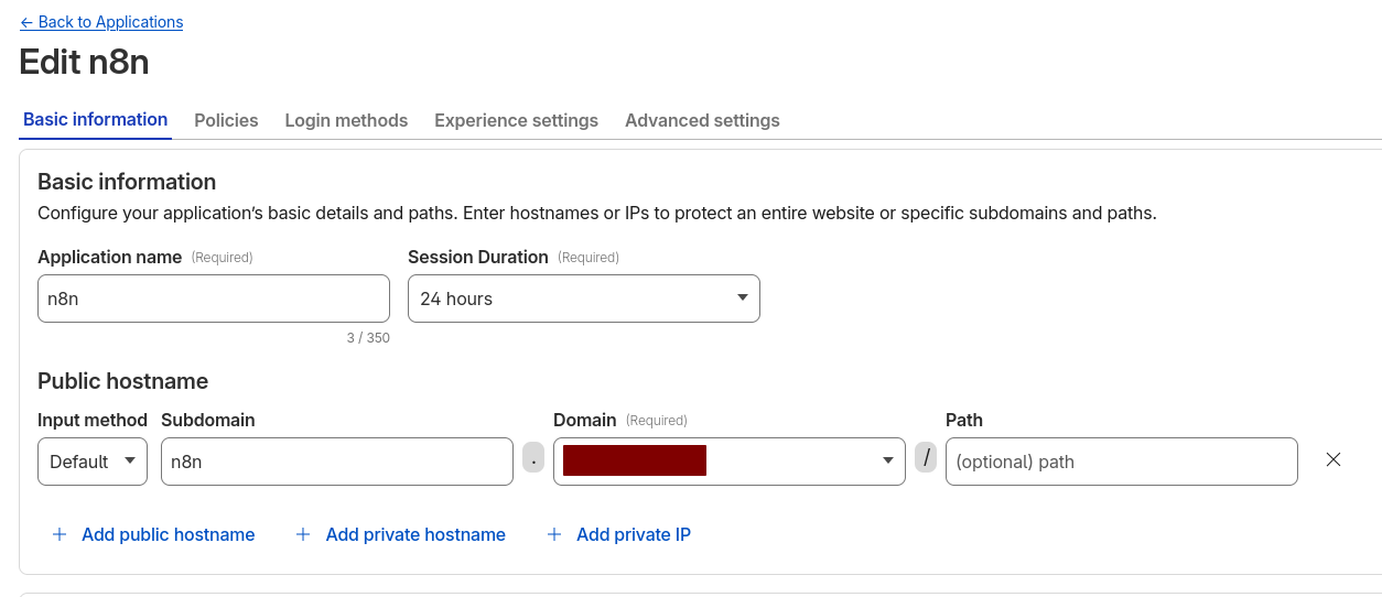

To allow Claude.ai to access my instance, I set up a Cloudflare tunnel with, for now, a very open configuration in terms of access rules:
Policies
In the logs of my n8n container, I can clearly see the connection request and its acceptance:

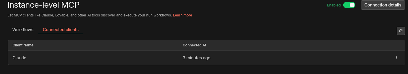

And the request shows up in the connected clients on the n8n interface:
But on the Claude.ai side, the connector is still not… connected.
