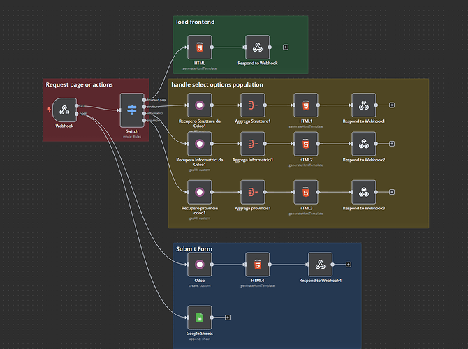

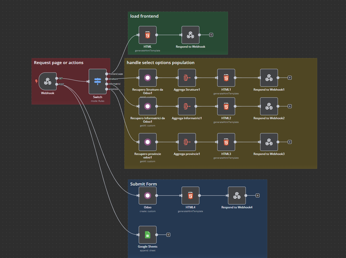

It works like a charm! Completely custom UI HTML form, with dynamic select populations on load page, with custom graphics.
2 steps forms with local storage saving and confirmations
This confirms you can create one-page app application without buildstep
i have just use htmx, bulma for simple CSS settings, validator.js for validating form field and some custom JS for fuzzy search in select options.

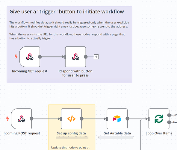

I’m new to the community, and so this might be covered elsewhere, but I’ve had some good success using webhooks to create a bit of a web front-end.
I’ve also thought about using HTMX, but I haven’t gotten that far yet!

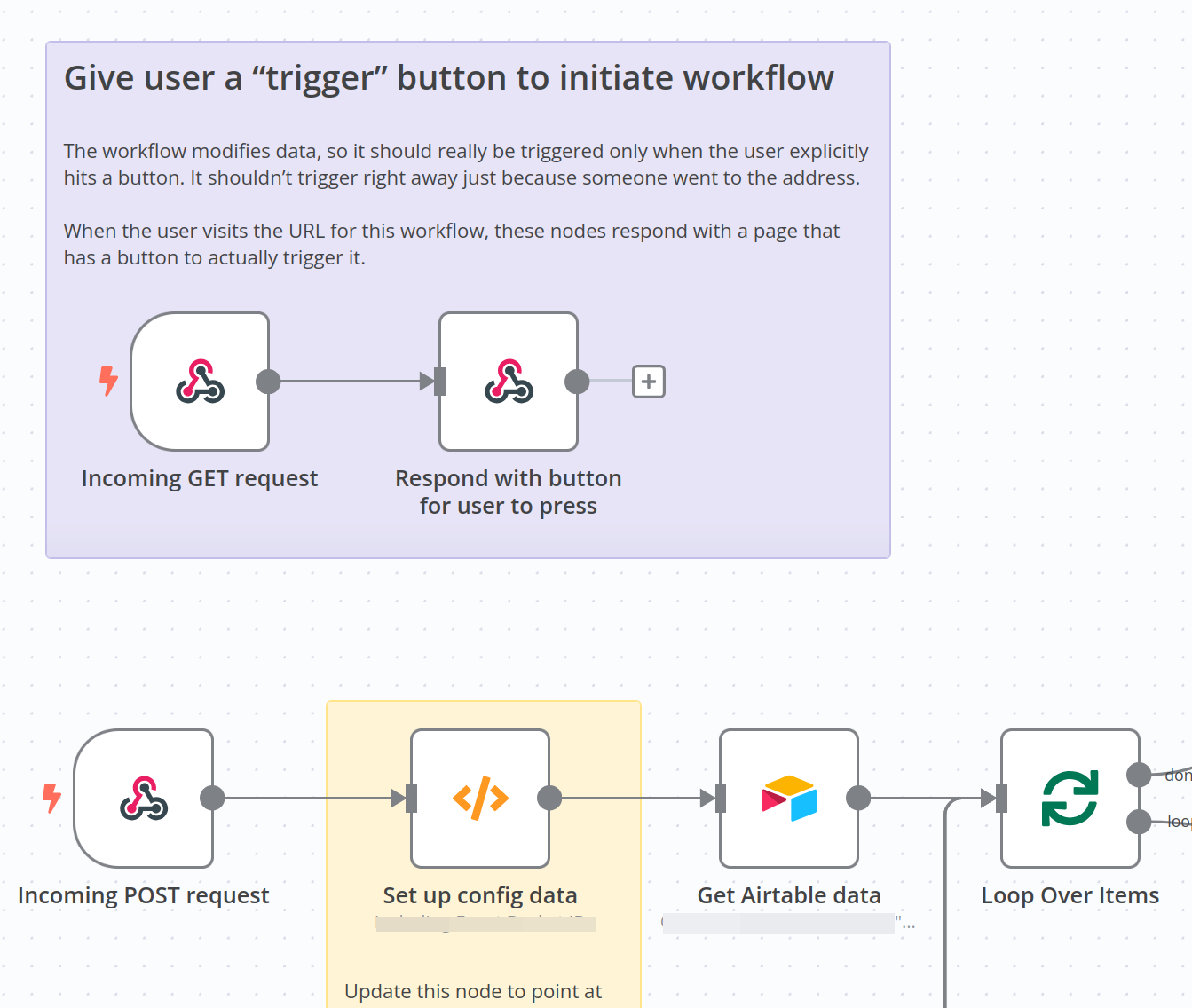

Basically, I’ve got a workflow that copies data from Airtable into another system (to keep the other system up to date). I’d like for non-n8n users to be able to initiate this workflow, so a webhook seemed like a good solution.
I wanted to make it a bit cleaner than just sending someone a URL and saying when they visit it, the workflow gets triggered. Plus, you can only send a GET HTTP request in your browser when you visit a URL and the pedantic side of me thought, “we shouldn’t really push data on a GET request, anyway… that should happen only with a POST request.”
So, I made TWO webhook triggers, both with the same path, one each for GET and POST requests. For the GET webhook, I used a Respond to Webhook node with HTML that included a form/button to generate a POST request to the same URL.
It’s worked out nicely. With the response to the first request (the GET one), I can put messages to users in the HTML about what will happen when they hit the button, etc.

as for post and get requests currently you can also do them all from the same webhook without creating 2 of them
Let’s say that using htmx and seeing that it works opens interesting doors for creating entire interfaces and single-page applications without having to use frameworks or build steps that you can’t use on n8n.
as for post and get requests currently you can also do them all from the same webhook without creating 2 of them.
Or you can do as you did two separate webhooks
That’s a really great idea… I didn’t realize you could have it respond to >1 verb! I’ll have to try that out!

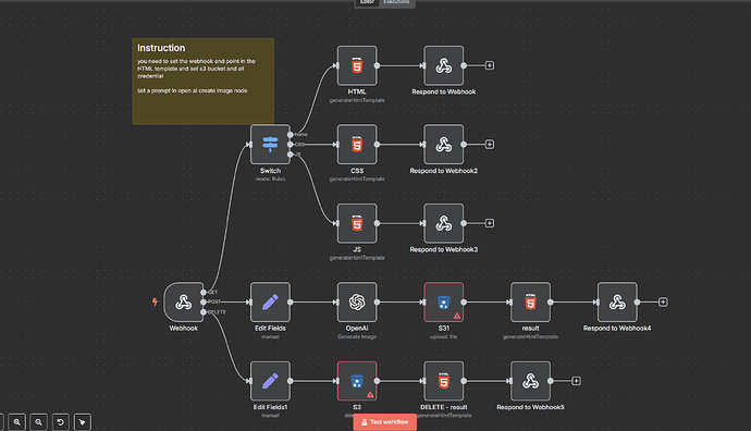

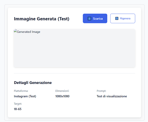

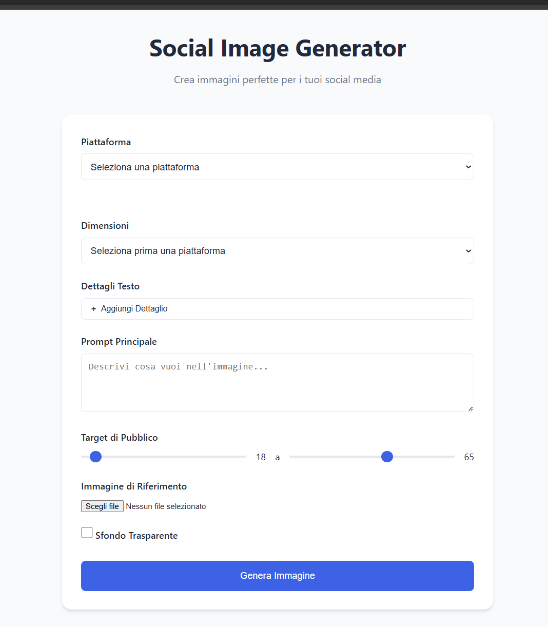

Here another example on what you can create with htmx and n8n
(its not a final version and is not production ready you need to change and finish to set some stuff)
This is the second part
