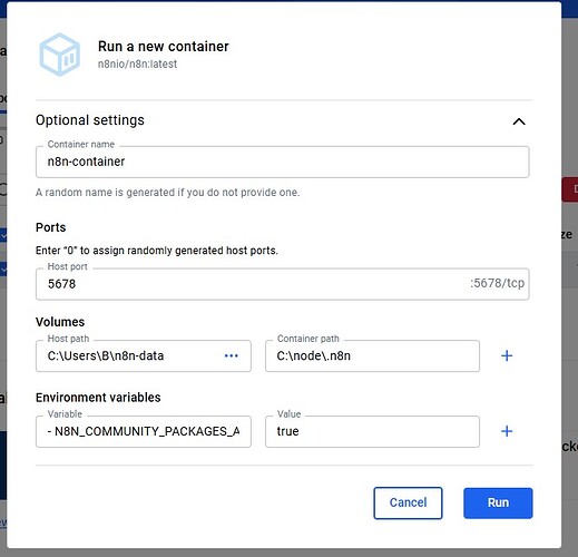

Http 500 error invalid mode when trying torun a n8n container in Docker Desktop

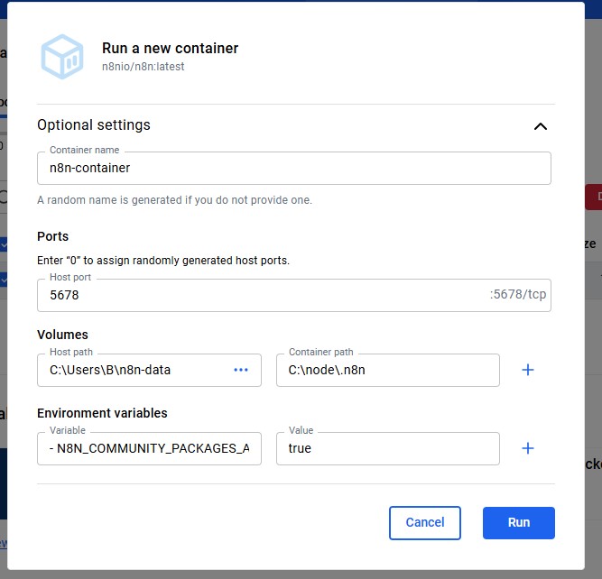

i get a http 500 error invalide mode when trying torun a n8n container in Dicker Desktop. see attached
The mistake is caused by an invalid volume path format. Docker on Windows needs Linux-style paths even for Windows host directories.
Correct your volume mapping:
Change:
C:\Users\8\n8n-data → C:\node\n8n
To:
C:\Users\8\n8n-data → /home/node/.n8n
The container path /home/node/.n8n is the default directory for n8n data within the container. Map your Windows host directory to this path.
Modify your volume setting to:
Host path: C:\Users\8\n8n-data
Container path: /home/node/.n8n
This should solve it.
If this was of help, please mark it as solution.
thankyou.
Thank you . That did work.
