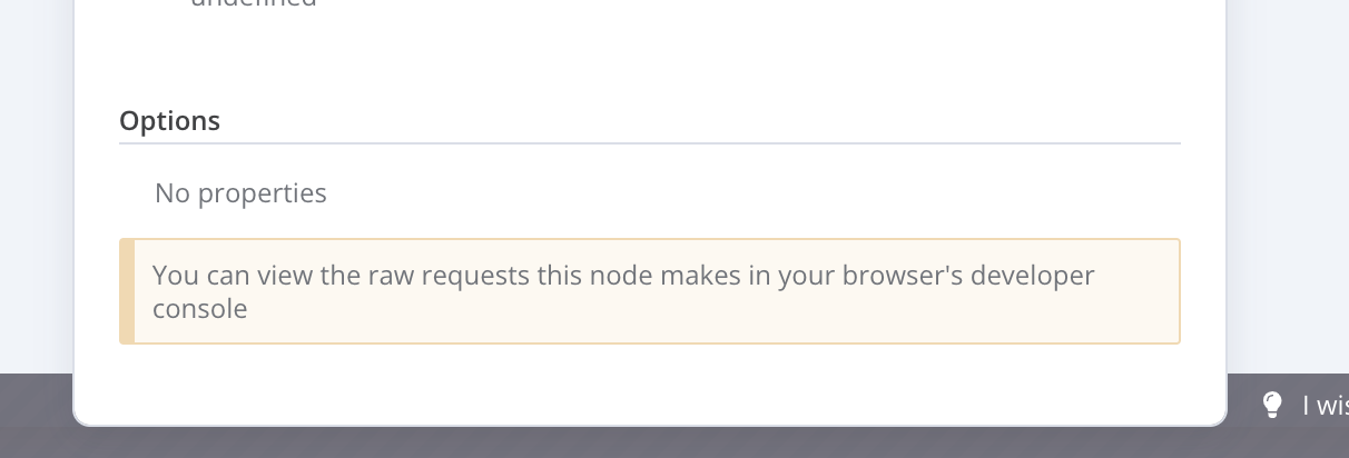

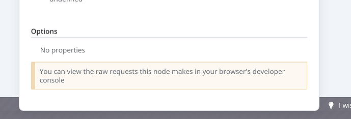

What I don’t have is this “Add option” button on the hosted version.

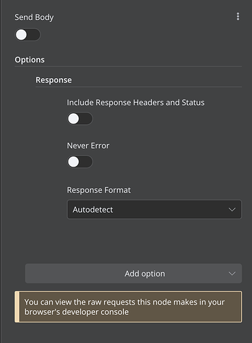

Here is the cloud version
Here is the hosted version:

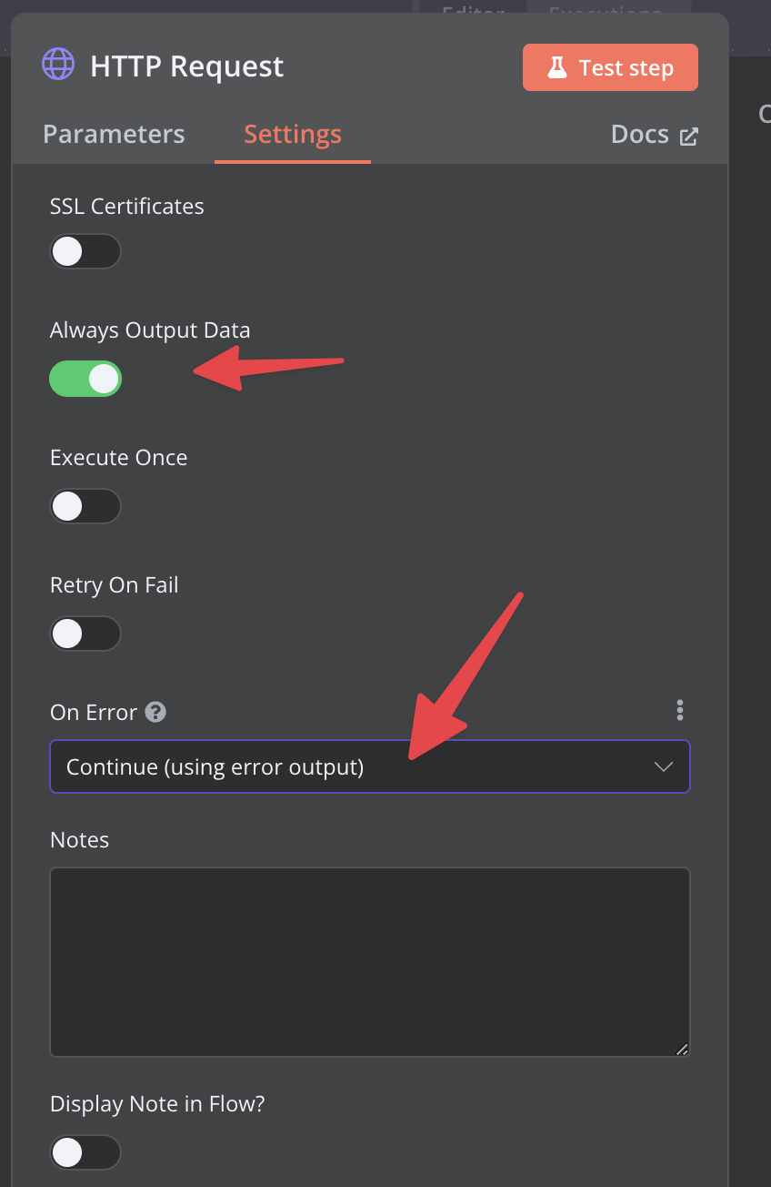

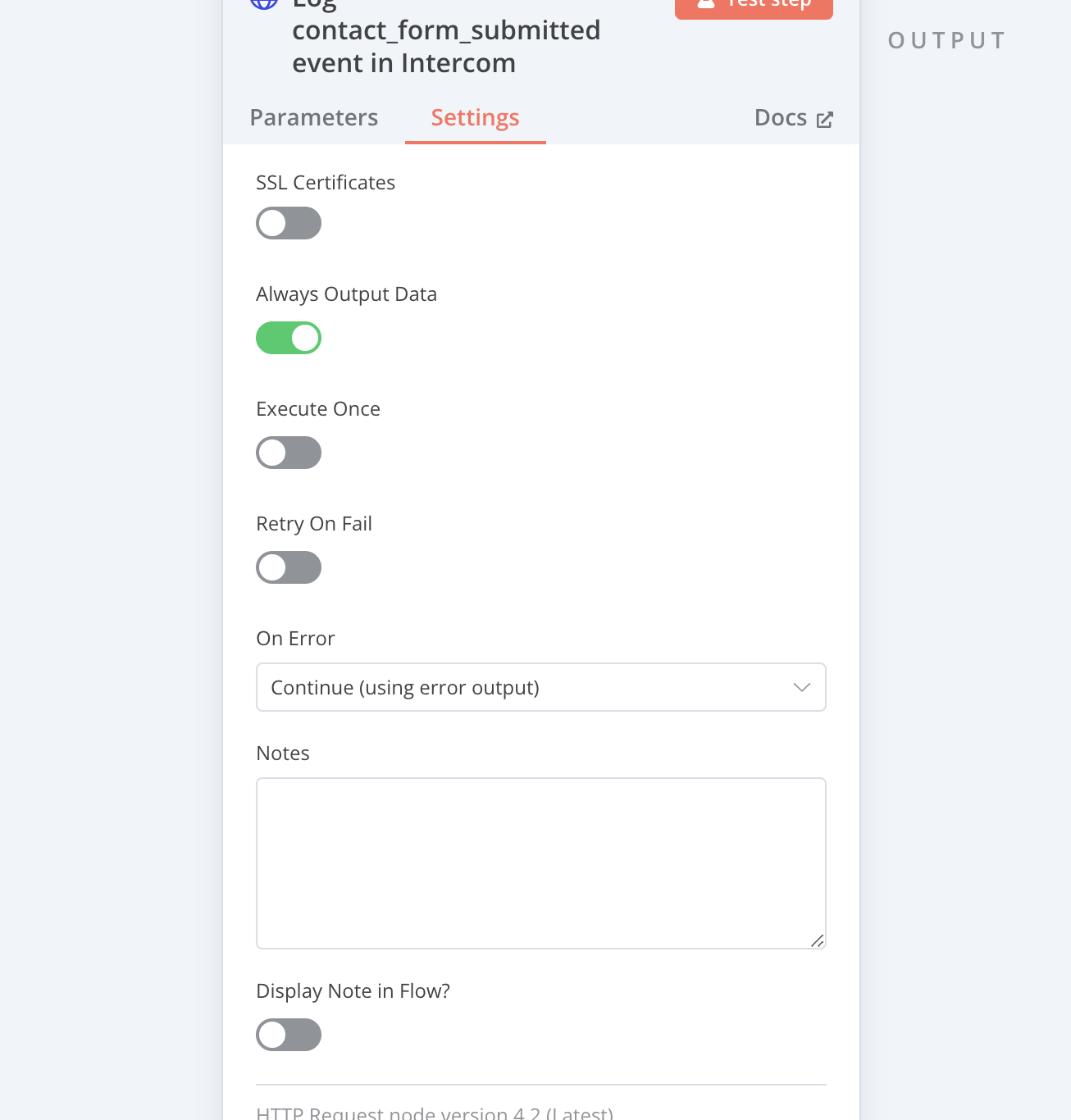

Now I indeed have and already checked the settings from your screenshot, as mentioned in my first post:
However, when running the node with these options, even though it correctly works, it’s marked as error in the executions (and the whole execution of the workflow is seen as failed), which makes is super hard to see when a real failure happens… What I would like here is to have a success state for the node / workflow execution, by just ignoring the error.
aaaa yes, the never error option was what you are looking for.

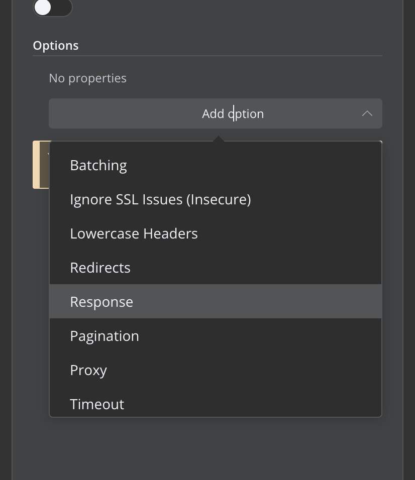

Did you try adding a new http node? Not copying an existing one but add a new one.
No. I just did and it works well. I could have done it sooner, didn’t think it could have an impact, but that’s the mystery of tech… :slight_smile:
