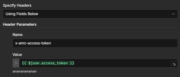

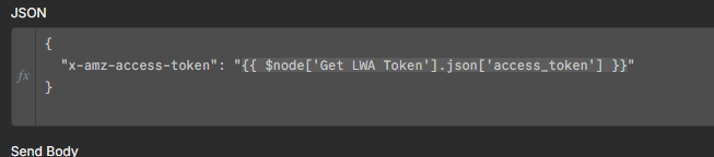

I also noticed this referencing:
Try this instead:

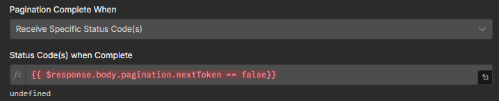

Without Enabling Pagination I am able to get output but till 1st page only but after enabling Pagination its keeps looping
Okay,
hmm the loop is probably happening because “Status Code(s) when Complete” expects a status code, but you’re passing an expression instead:

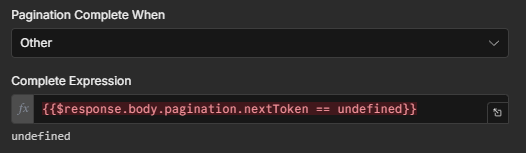

Try changing it to “Other”:
Then write a suitable expression like:
{{!$response.body.pagination.nextToken}}
or
{{$response.body.pagination.nextToken == undefined}}
I’m just guessing since I can’t see the output, but hope this helps!
Thank you so much, it worked
