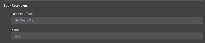

Can you try remove the name field from the http node? Or is it required?
I don’t have any field called " name " on http request node
please any other suggestion
Right here? Is it not removable? I wonder if the binary is provided but name is not for some reason?
name it’s just a label not a field
Oh yes my mistake, I see, the name of the form param. Shouldn’t be an issue.
