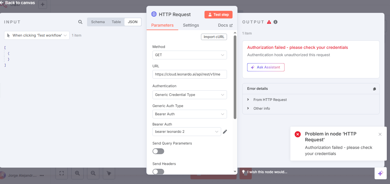

Hello n8n Community,
I am having a persistent 401 Unauthorized error when trying to connect to the Leonardo.AI API using the HTTP Request node.

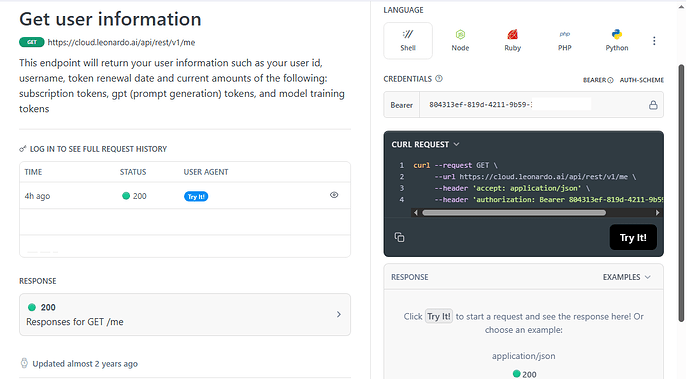

The key issue is that my API key is 100% valid. I can get a successful 200 OK response using the exact same key with an external cURL command, but it fails every time from my n8n.cloud instance.
I have tried creating both Bearer Token Auth and Header Auth credentials in n8n, and both methods fail. This suggests there is an issue with how n8n is sending the Authorization header for my specific account.
“errorMessage”: “Authorization failed - please check your credentials”,

The output is the same 401 Unauthorized error shown above.

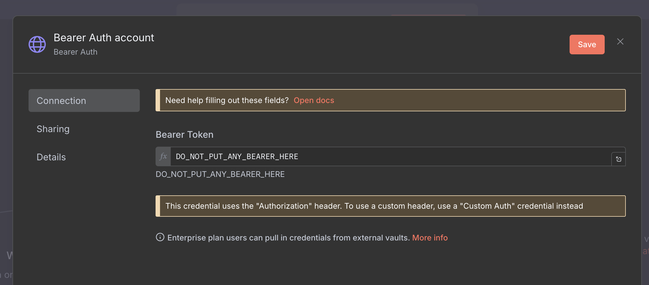

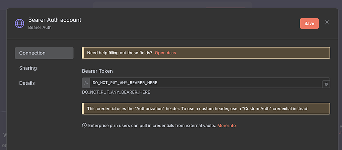

Hi there, i noticed you are using the bearer auth, which is correct,but u have to note that the bearer auth, put the "Bearer " in the background, so in here (image below) no need to put any Bearer ${API_KEY} again, but just put ${API_KEY}
