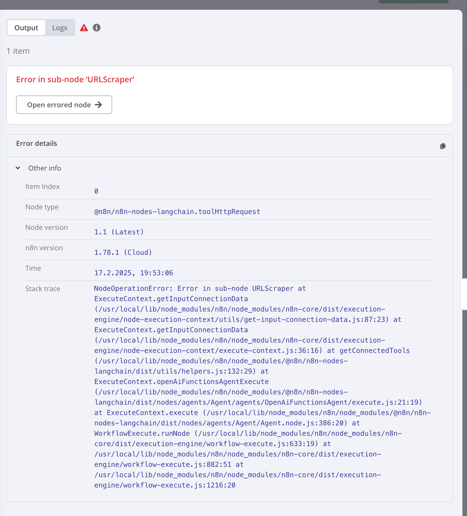

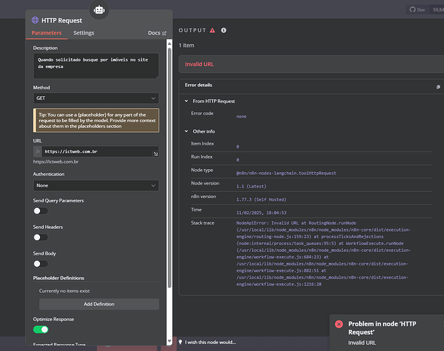

I`m trying to use it with from AI function, but for some reason I get this
I believe that everything is set up correctly and if I give it values the http tool works (google flights). So Iчm not sure what the issue is, please help!
Hello, I’m facing the same problem here…any idea how to fix?
n8n version: 1.77.3
Postgres
Docker
Linux Ubuntu Server
I ended up here because I googled exactly the same problem.
Trying to pass a URL to an HTTP Node using $fromAI.

$fromAI is not currently supported in the HttpTool, you need to use the {placerholder} syntax described in the yellow tip box when you open the node.
Hey, sorry for the delay here.
I can’t reproduce your this error with your posted example, though the name also doesn’t match up.
I did see a similar error in the past when there was an empty space character before the URL in the httpTool, so watch out for that and let us know if this issue persists on the latest release.
If you try to open the errored node, appear some specific error ?
Update, I believe that I fixed it by allowing the AI to fill it automatically
