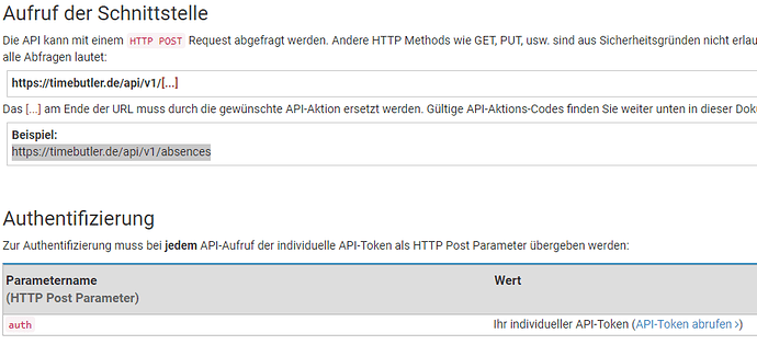

next thing: I have a Restapi that i would to ask on. He have a API Key that works together with an auth parameter.
Does it use: header authentification ?
Have you any idea ? the users parameter in Header ?

@Stefan looks like the auth parameter goes in the body not the header. So add it to the body and remove the header ”users”.
I like to have to generatethis request: https://timebutler.de/api/v1/users together with a auth = 9988…

What @RicardoE105 did send is correct according to their documentation. Sadly does their documentation seems to be wrong. Instead of HTTP Post Parameter “auth” it has to be send as a GET. Also does the API return data as CSV.
So this one will work:

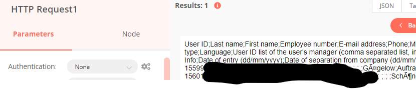

Hi, i have a question about http reuqest (your best node): The API Timebutler gives me an csv file back but, there is some trouble with the charset ( it looks like utf8, but it isnt) I have set the mimetype but it dont be a solution (text/plain; charset utf8)
What do you think ?
Stefan

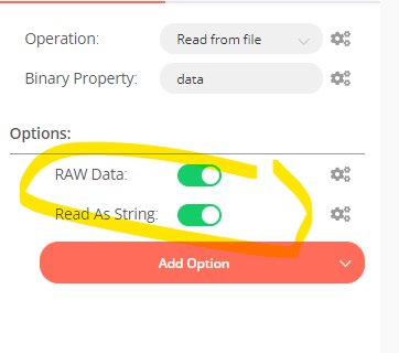

Does this one help?
Thanks for your hint.
So just to be sure. It works now fine?
