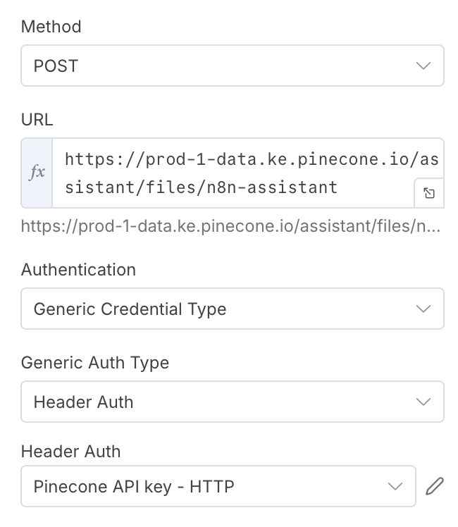

To solve your problem, instead of using the Predefined Credential for PineconeApi, which is for the Pinecone Vector Store node, you’ll need to use Generic Credential Type and add it to the Header like this:

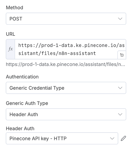

And then use Api-Key as the value:
Give it a whirl and let me know if you have other questions about this. Again, I’ll share my template shortly!
