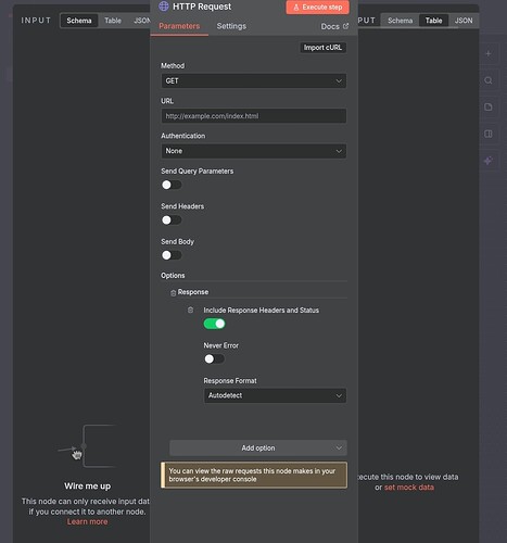

Hey @Sai_Meister !
I see that there is a 200 response, it means that your server responded ,but with false.
I think you have to add option “Response”(Include Response Headers and Status) in the HTTP node , so you can access the JSESSION.
If you share your raw Postman curl, maybe we can help to configure the n8n HTTP node, since as you can see it may behave different, depending on the endpoint.

I don t know how Postman handles the cookies, but n8n handles them as you set them…
The “exact” curl into HTTP node (the variant you shared users different format – instead - - etc…)
Or body with FormEncoded Url:
P.S !
You have to tweak with the Response and the Redirects to see Status code andd Response headers… and better create Custom Auth credentials
Cheers!
