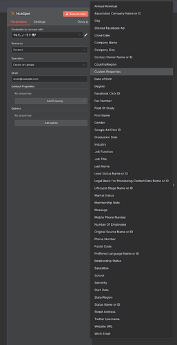

For example, I have 200+ properties in the contacts object on Hubspot, but there are only 50ish properties showing up on n8n. Here is the suspected code that is not working properly:
  • I verified with the Hubspot API that the API is sending all 200+ properties, so the scope or the API key is not the problem here.
  • The Custom properties option works fine. I just can’t access default properties that are not hard coded in the n8n node. Not even sure why these are hard coded in the first place, when there is a function that fetches all properties from the API.

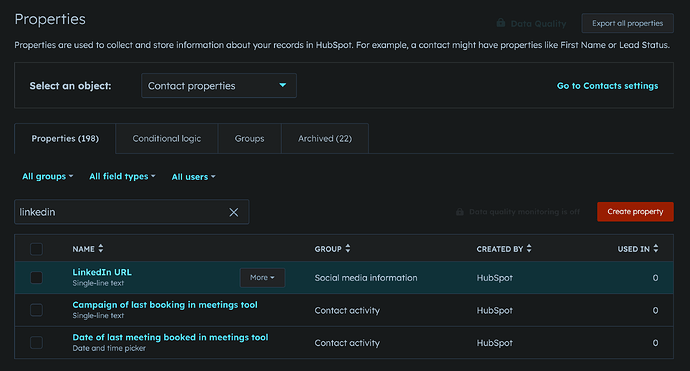

Hubspot Property Configuration
I want to update the LinkedIn property, but this doesn’t show up on n8n no matter what I do.
n8n Property Options
There are only hard coded properties and the option for custom properties.
