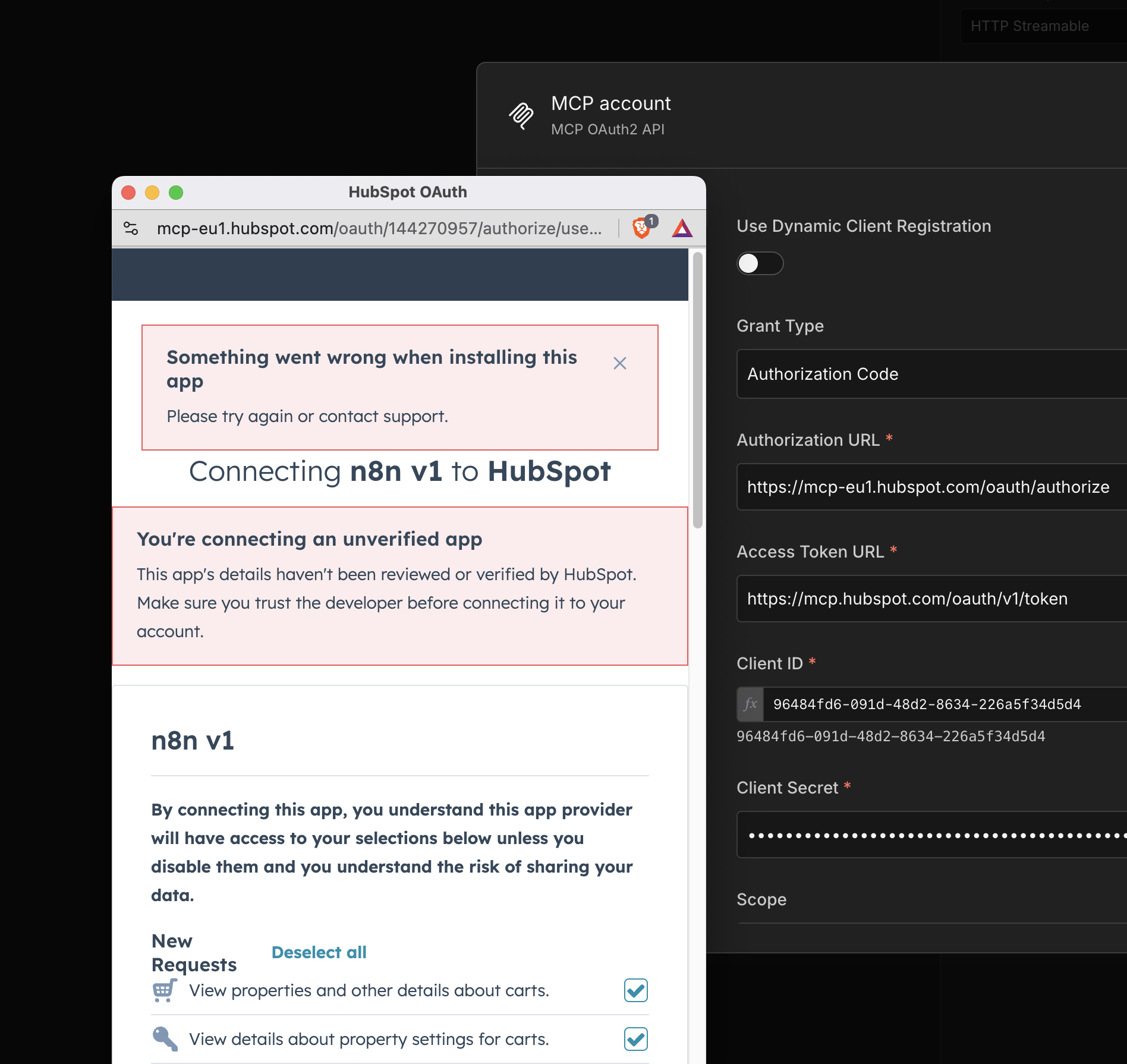

I am trying to use the Hubspot MCP server node with the MCP OAuth2 API inside n8n with the following settings:
Grant Type PKCE
Authorization URL https://mcp.hubspot.com/oauth/authorize
Access Token URL https://api.hubapi.com/oauth/v1/token
Client ID Hubspot ID
Client Secret Hubspot MCP App Secret
Scope oauth
Authentication Send credentials in Body
Auth URI Query Parameters Leave empty

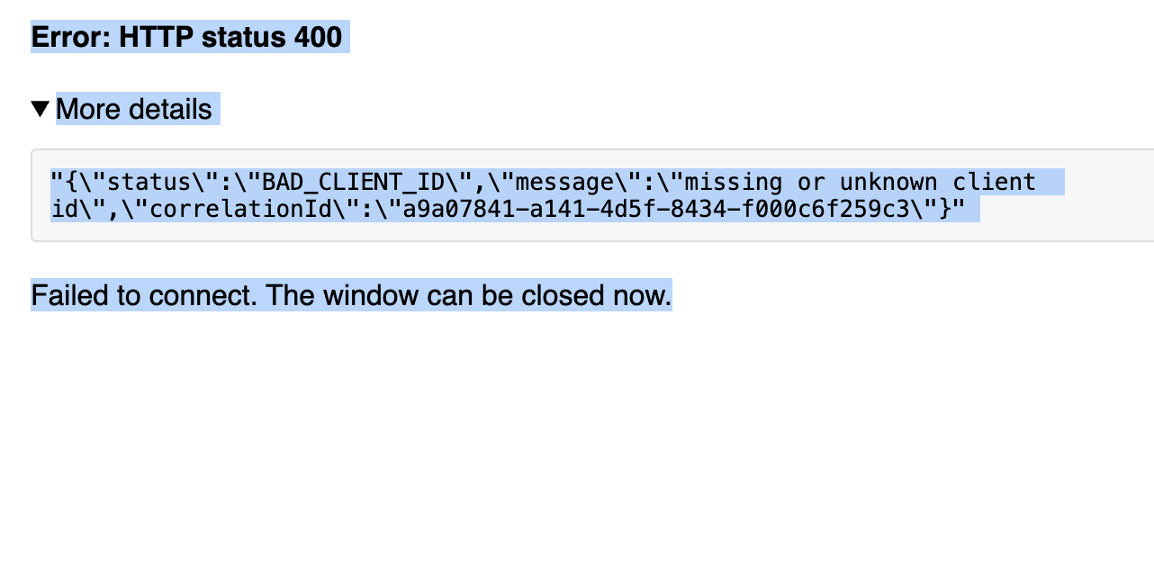

Once i try to connect the app, choose my account and enable different permission scopes i finally retrieve this error.
Anyone knows how to solve this?
THANKS!
Runnning the n8n instance on 2.2.3 via Hostinger VPS.

I swapped to “Authorization Code” as Grant Type and tried different URLs.
Getting another error this time. Can you help us out and maybe test this on your side here?

Thanks guys. Adjusted the URLs and now I get this error message:
”Error: Insufficient parameters for OAuth2 callback.
More details
Received following query parameters: {"error":"invalid_request","error_description":"Missing or unknown code challenge","
Any ideas?
