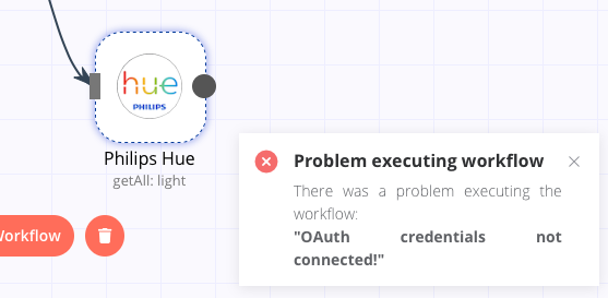

Hi, I have some trouble to get the HUE connector working. I already did create a developer account for some other apps. I just created a new “app” like described here.
https://docs.n8n.io/credentials/philipsHue/
I always get the error
Error: OAuth credentials not connected!
    at Object.requestOAuth2 (/usr/local/lib/node_modules/n8n/node_modules/n8n-core/dist/src/NodeExecuteFunctions.js:56:15)
    at Object.requestOAuth2 (/usr/local/lib/node_modules/n8n/node_modules/n8n-core/dist/src/NodeExecuteFunctions.js:419:42)
    at Object.philipsHueApiRequest (/usr/local/lib/node_modules/n8n/node_modules/n8n-nodes-base/dist/nodes/PhilipsHue/GenericFunctions.js:24:49)
    at Object.getUser (/usr/local/lib/node_modules/n8n/node_modules/n8n-nodes-base/dist/nodes/PhilipsHue/GenericFunctions.js:36:54)
    at Object.execute (/usr/local/lib/node_modules/n8n/node_modules/n8n-nodes-base/dist/nodes/PhilipsHue/PhilipsHue.node.js:105:67)
    at Workflow.runNode (/usr/local/lib/node_modules/n8n/node_modules/n8n-workflow/dist/src/Workflow.js:489:37)
    at /usr/local/lib/node_modules/n8n/node_modules/n8n-core/dist/src/WorkflowExecute.js:369:62
    at processTicksAndRejections (internal/process/task_queues.js:97:5)
What can I do? What are my options to debug to get further details? Is it even a “HUE” problem or what does the error message means

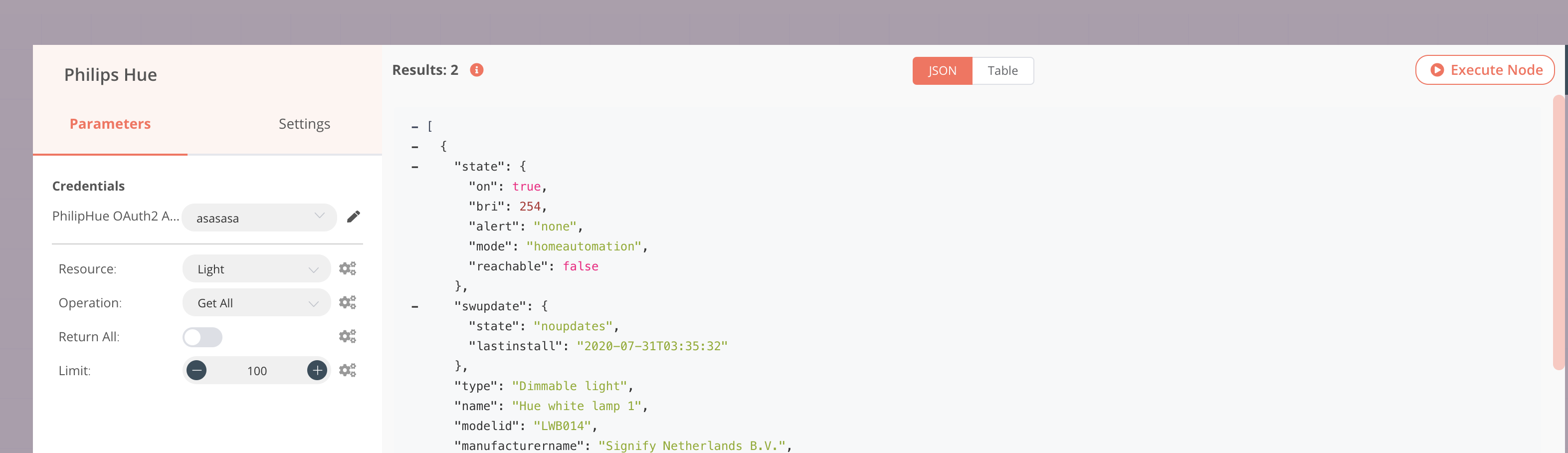

Welcome to the community @josema!
To connect you have to open the credentials and then press on the circular orange button left of “Not connected”
Screenshot from 2020-10-16 16-13-08
After you did that it should work fine.
Hi jan, thanks :grinning:
I just realised that the button is still “Not connected”. If I press the button, I get a message in the lower right corner.
## Credentials updated
"hue" credentials were successfully updated!
But the button remains “Not connected”
Wonder if that is some strange UI issue. Did you close and open the credentials again? Does it then still display “Not connected”?
yes I did. But it is still not connected. I also run the workflow → same result.
Quite weird. Just tested it and it’s working fine for me.
If you go back in the credentials does it display them as connected or not? If not, please try to restart the browser and try to connect with the connect button again.
I tried it a thousand times … go forth and back, did use a private mode window, cleared the cache and what not
I made it work using another browser. Did finally use the Chrome browser and a pop up appears… it seems that safari was the problem :man_facepalming:
