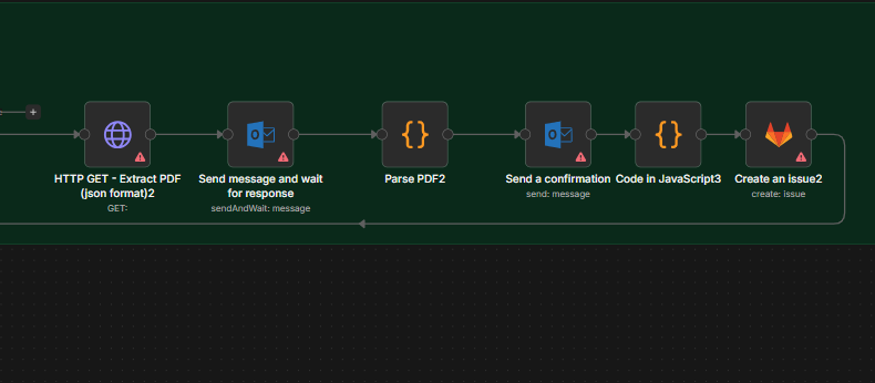

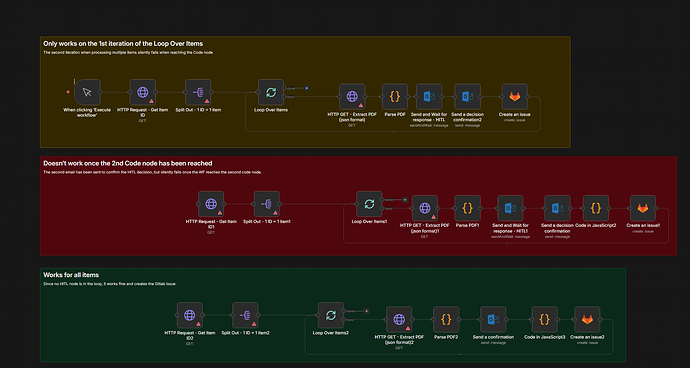

Kindly find a picture of 3 scenarios which are reproducing the different steps of our workflow and showing the global approach which fails following to a HITL node. Our current workflow is way bigger than the ones shown in our example, but we would like to avoid complexity in this issue assessment and ensure us confidentiality around the process we are applying in this workflow.

Thanks a lot for your suggestion! Unfortunately, this doesn’t really help us… in our workflow, we have already several nodes between the HITL node and the Outlook Confirmation node, therefore we concluded that this might not be related to an Outlook overhead. In the example you’re suggesting, during the first iteration, you’ll get the HITL email and be able to approve or decline the request. In both case your answer will lead to nothing and the workflow will never follow the process, the confirmation message will never be sent and you’ll have to stop the execution manually to end up with no error message / log. The execution logs will show an execution stopping at the HITL node (like if no answer were received) and its status will simply be showing “Canceled” with no visible error.
This is entirely due to the fact that a function node was positioned between the 2 Outlook nodes. If you remove the function nodes, the first iteration will succeed but it will again fail during the second iteration of the Loop Over Item, as soon as it reaches a function node.
After many tests, with different ways of node positioning, the single progress we made is to have at least one working iteration, by moving the function node before the HITL message; following to our tests, we have concluded that the issue is related to the function node type positioned after an Outlook Send and Wait message context. As soon as your function node are positioned before the Outlook HITL, it works for a single iteration. Not for multiple iteration when looping the process with a Loop Over Item node
