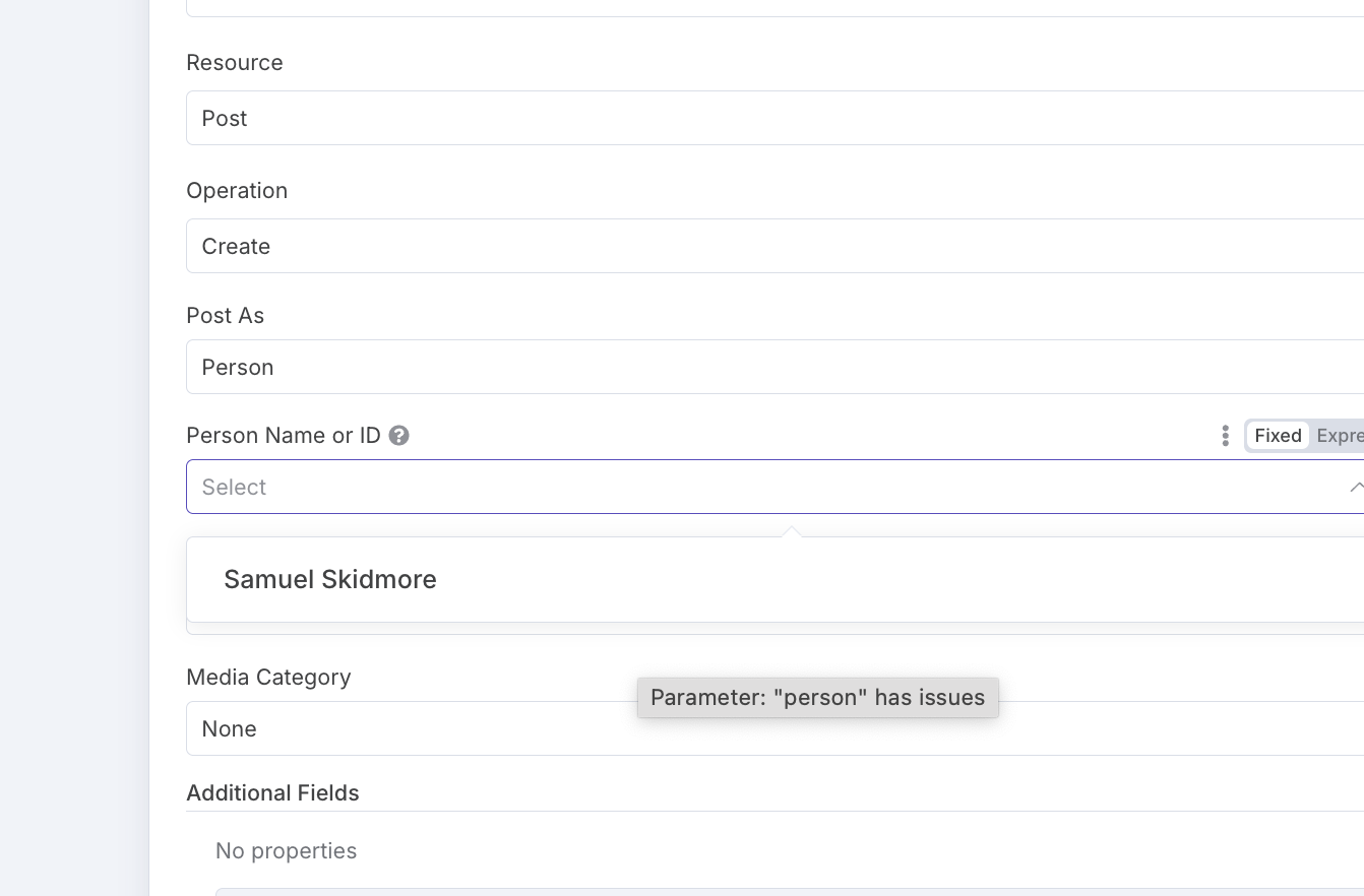

I am getting this error "Issues: There was a problem loading the parameter options from server: "Unable to sign without access token". while connecting my linkedin account. Can anyone suggest me the exact steps to connect linkedin with n8n
I have been trying to connect my LinkedIn but its not connecting. Watched a lot of Youtube videos but didn’t help.
Plaese help me fix this error.

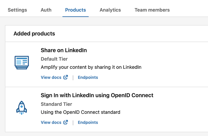

Hey,
This was a werid one, but I got it working,
to confirm,
These are my setting I used, above.
But it was strange because at first, I got the same error fetching, then I changed to post as organisation, put my company ID in, then said issue about another permission.
I got this Bad request - please check your parameters Organization permissions must be used when using organization as author
I went back to Post as Person, and boom my account appeared and I could send a post to my LinkedIn.
I think just switch between Post as Org, back to person might fix it.
Hope this helps.
Hello, I am having trouble running workflow as it gets caught up on my LinkedIn authentication. I am trying to “Post as Person” but it cannot find my Person Name or ID. Can you help?
Which error do you see?
