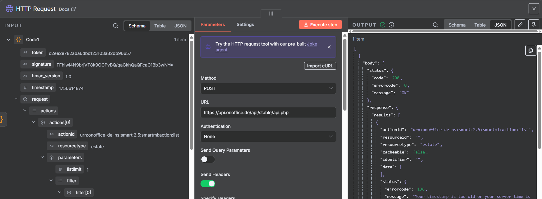

I am integrating onOffice with n8n to fetch property details using an object ID from a webhook, but the API call returns no data—likely due to incorrect action type or field parameters—so the task is to fix the setup so n8n reliably retrieves it
I’m working with onOffice and n8n, and I’ve set up a webhook that sends an object ID when a process starts. The problem is, even though the API connection and HMAC signature are correct, the request returns empty or no data. I suspect it’s due to the wrong action type or field parameters, and I need to adjust the integration so n8n can reliably fetch the property data using that object ID.
There’s no explicit error message being returned from the onOffice API — the request goes through successfully, but the response is either empty or missing the expected property data.

  • n8n version: cloud
hi there  , can you paste your workflow wrapped inside a code block like this? it will make it easier for us to take your workflow and debug it
I used pinned data given in your workflow.
it make sucessful request.
here is code I also made some changes too:
