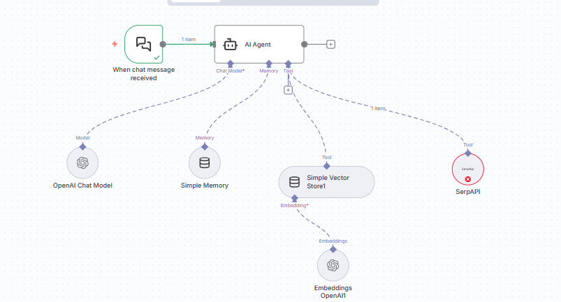

I am unable to display the required “q” field in SerpAPI when I add it to my AI agent
Hello,
I’m having a problem with the SerpAPI node in n8n.

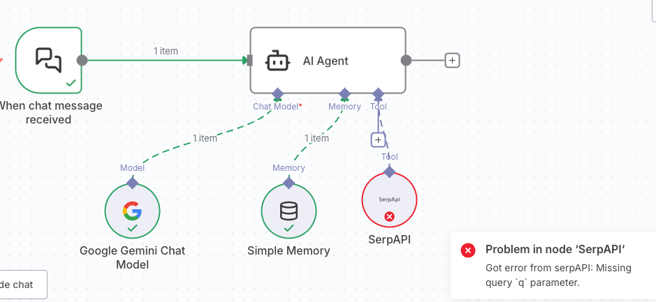

When I add it as a tool to my AI Agent, I don’t see the “q” field at all, even though n8n tells me it’s required to run a Google search.
As a result, I get this error:
Missing query q parameter.
I only have access to options like country, device, and language, but not to the “q” query.
I don’t know if this is a bug or if something is missing from my configuration.
Thanks for your help!
Hi @Nolame
As SerpAPI has a bug please use “SerpAPI Official Tool”
i’ve made a similar workflow to your and tested it.
Works well on my side.
I was testing SerpAPI and it returns same error as it was returned on your side.

Hi @Iheb-Rjeb ,
You need to change the “SerpAPI” node to “SerpApi Official” node.
It’s the one that appears in your search bar. The node that you’re using in your workflow is a different node.
