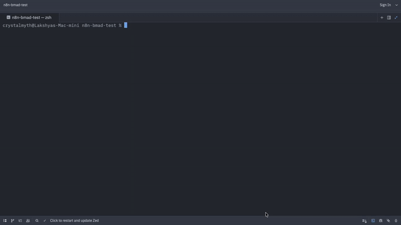

bash
npm install -g n8n-bmad
n8n-bmad init
It walks you through setup interactively — asks for your n8n instance URL and API key, creates the project structure, and generates the Claude Code commands.
ScreenRecording2026-02-07at3.09.08PM-ezgif.com-video-to-gif-converter
