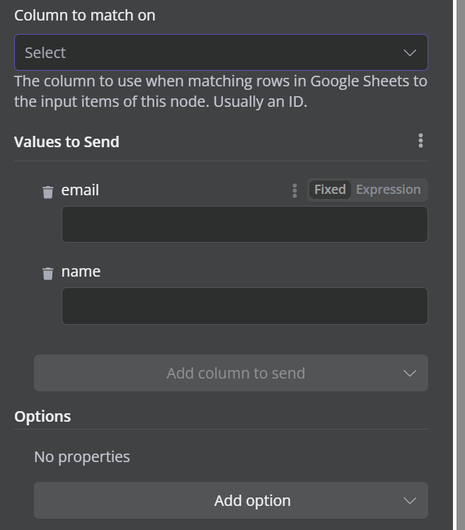

As far as I can see, the appendOrUpdate node provides the following options:
Are you saying you are unable to understand what to use in the “Column to match on” field?

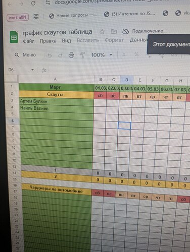

I want to enter data about work shifts into a table using an AI agent. A request that will compare the last name, first name and date. The letter “s” will be placed in this cell

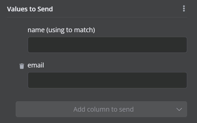

You should then select “Column to match on” as the first column (name) and then pass on the value as “s” in the correct column.
For example, if you wish to add “s” in D3, in this section:
you should send the name as the name of person and then pass the "03.03: field as “s”.
