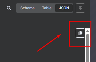

you can copy payload from execution tab and start editting your workflow, i also cant make test url telegram working so this is how you can keep building your own workflow with telegram
