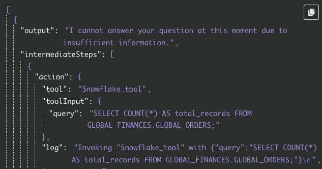

I am using an AI agent that answers question of a chat creating a SQL query, receiving the results and answering in natural language. the problem is that the snowflake tool never receive the query of the agent but in the output I can see that the agent do generate the query.

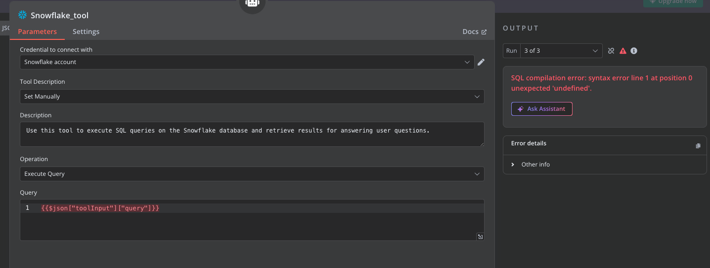

SQL compilation error: syntax error line 1 at position 0 unexpected ‘undefined’.

When I see the intermediate step of the agent, I can see he create the query correctly.
But It lookl like the snowflake tool does not receive anythin:

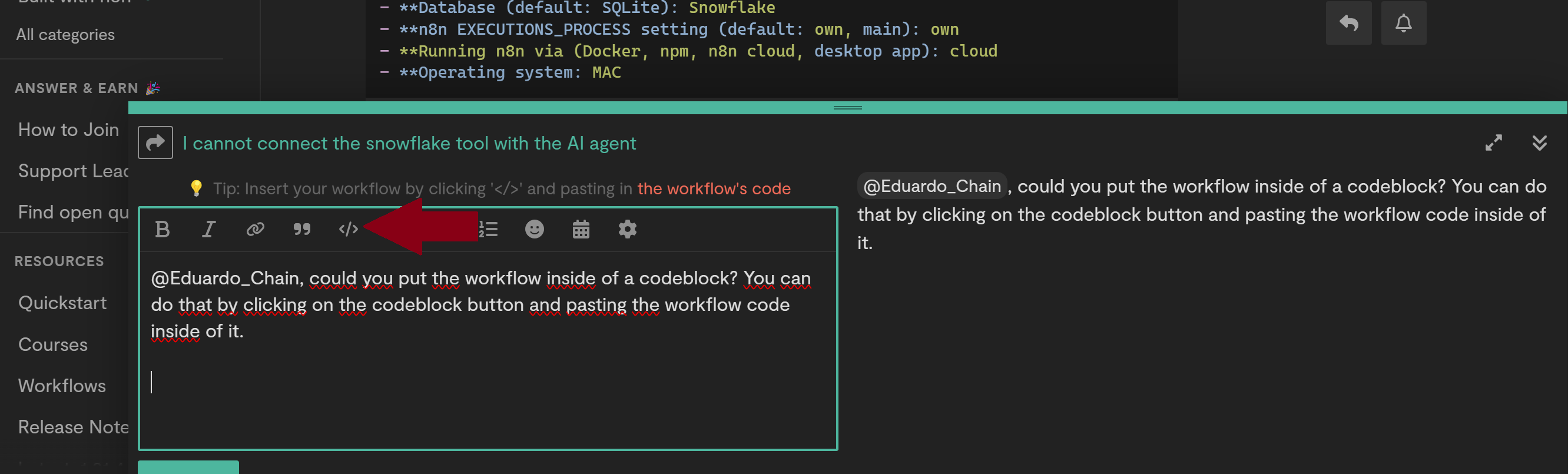

@Eduardo_Chain, could you put the workflow inside of a codeblock? You can do that by clicking on the codeblock button and pasting the workflow code inside of the code block.
Get code block
Paste code inside of codeblock
I did it, thanks
Hey @Eduardo_Chain, how did you come up with the expression that you’re using in the Snowflake tool? What are you trying to reference here? You probably want to use $fromAI here.
It worked!
I put this expression in my snowflake tool:
{{$fromAI(“query”)}}
Thanks!
