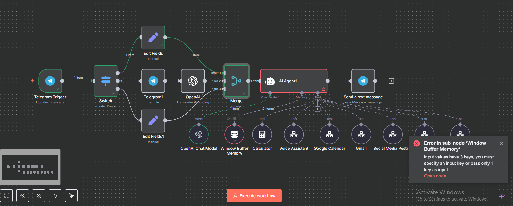

I can't change the number of input keys sent to my memory node

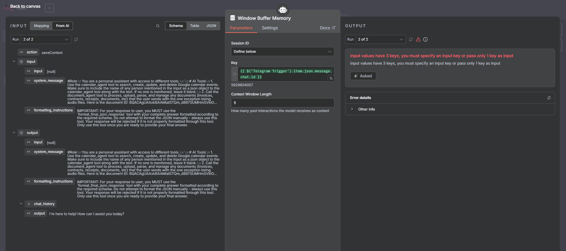

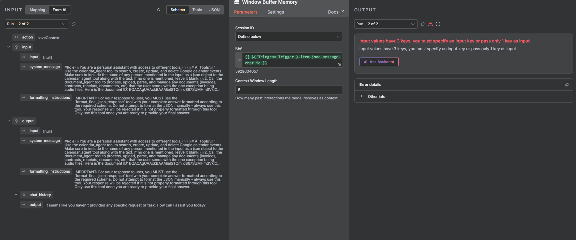

I am trying to use an ai agent to send a document to another workflow to be analyzed, but when it accesses the memory node, it somehow sends it 3 input keys. I can’t figure out how to bring it down to 1.
input values have 3 keys, you must specify an input key or pass only 1 key as input

Try this
the reason of your error is because there’s 3 input connected to ur agent, and all 3 goes back to the telegram trigger, so it got confused, with this, it merges it into 1 branch first before connecting to the AI Agent
I am still getting the same error
