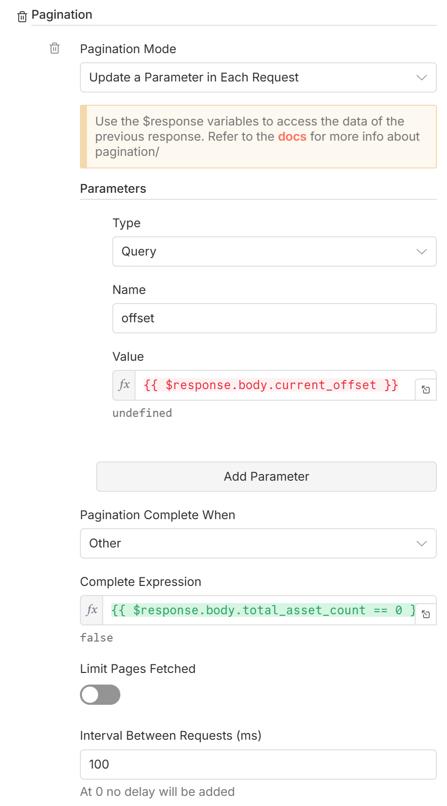

Here’s how I setup the pagination there:

As per your screenshot, the value of the response expression you have is red with “Undefined”. Can you show me the value of {{ $response }} only.
I think I figured it out - the completion rule should have been different - should check for something like total_asset_count == 0 (somehow, Gumlet thought it a good idea to set it to 0 when offset of “off”)
In the end, this is the configuration that worked for me:
