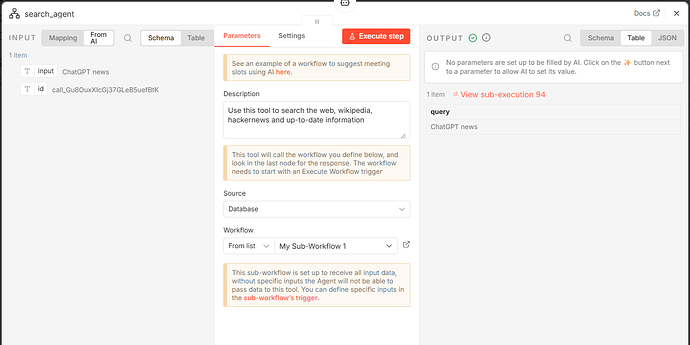

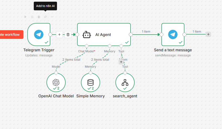

I made a workflow where an ai agent answer back if a user send a massage in Telegram. Everythings works fine. But when I want to ad “Call n8n workflow tool” and try to connect my sub-workflow, the data does not come through. (I used a simple description: “Use this tool to search the web, wikipedia, hackernews and up-to-date information”) I dont know what to do
No fields - item(s) exist, but they’re empty
Hi @Andras_Turnai
I wouldn’t treat this as the data “not coming through.” I’d treat it as the tool not having a defined input contract yet. Once you define the field on the trigger, the agent has something concrete to send, and the sub-workflow should start receiving it normally. What I would do is change the sub-workflow trigger from Accept all data to Define using fields below and add a field like query or input as text. Then go back to the Call n8n Workflow Tool node and pass that field from the agent, either with the AI-fill button or with something like {{ $fromAI(‘query’) }} if you want the model to populate it dynamically. Inside the sub-workflow, read it as {{$json.query}}.

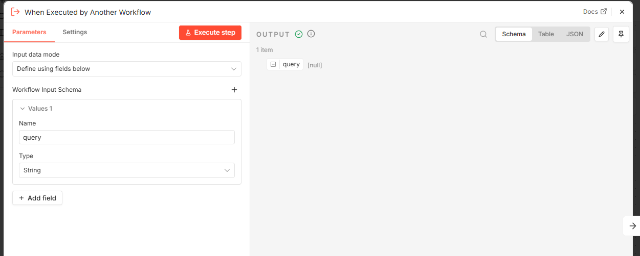

I tried but in the sub-workflow, the query=[null]

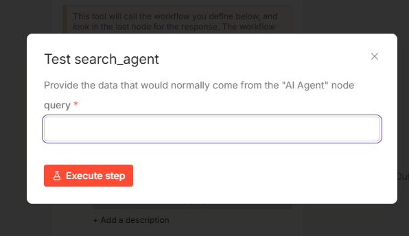

Yeah, I know but I don’t know what to type in the search_agent:

@Andras_Turnai make sure your sub flow is published, type anything in the query field, and once the sub flow will run in background wait until it finishes and there see the logs and there you will get the variables AI agent sends and how, and from there you can actually copy those and move ahead building your sub flow with that value so that whenever the main flow calls the sub flow the value passes down smoothly between further nodes.
Yeah I tried what you wrote, but the problem is that I tried everything to get something out of these workflows, but the subworkflow’s only data is [null].
Really have no idea why it doesn’t show any data..

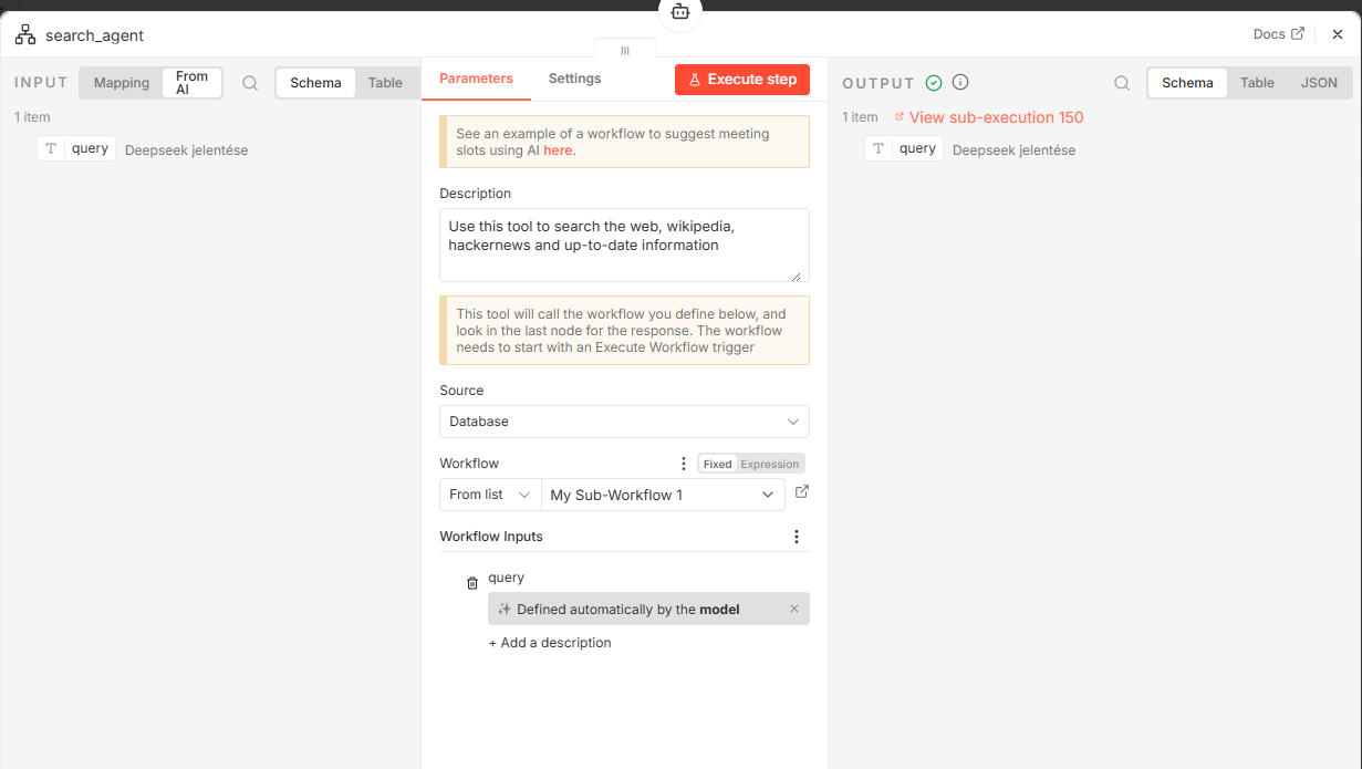

Now I found the solution.
The solution was that I had to copy the input of search_agent in JSON format which was something like this:
“input”: “Deepseek”
Then I had to go to the sub-workflow and edit the output, and paste the search_agent input. Then it worked.

yeah the issue is that call n8n workflow tool doesn’t know what inputs to send if your sub-workflow trigger is set to ‘accept all data’ mode. the ai agent needs a defined schema to work with. what worked for us was changing the trigger to ‘define using fields below’ and adding an input field like query as text. then in the tool node, pass {{ $fromAI('query') }} so the agent fills it dynamically. inside the sub-workflow, read it as {{ $json.query }}. since you’re hitting query = [null], the agent probably can’t infer what to send — defining the schema fixes that.
