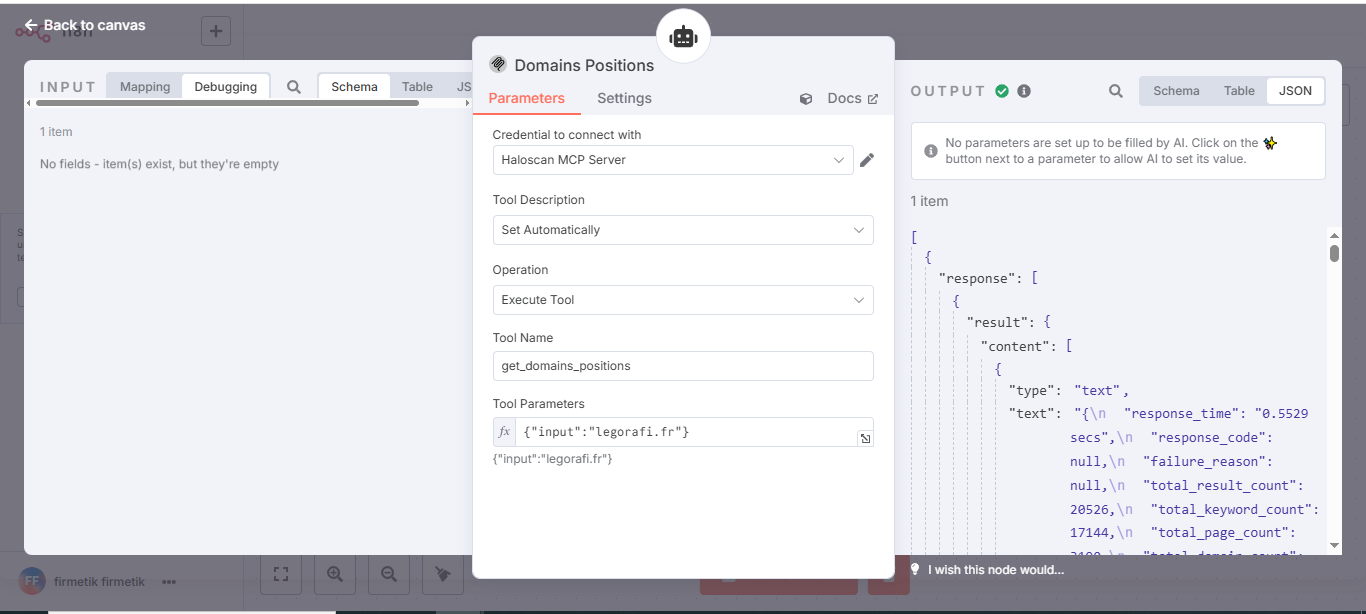

all good with my mcp server the tools are configured well idont get why the ai agent doesnt exucte the tool when i enter a chat
and when i test the tool without an ai agent it work very well like this

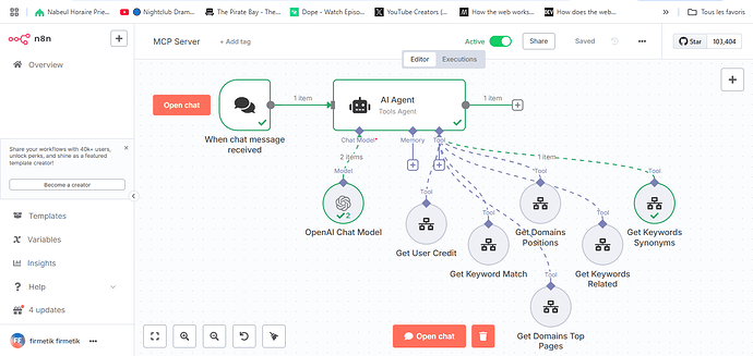

Hey, you will need to specify the system prompt, in the ai agent,
Checkout this post I made, let me know if this helps, I can provide further details if needed. But in essence, you need to get the ai agent to call it use the tool.
Oh and also, some model don;t; run well with tools, openai 4o has been most reliable for me.

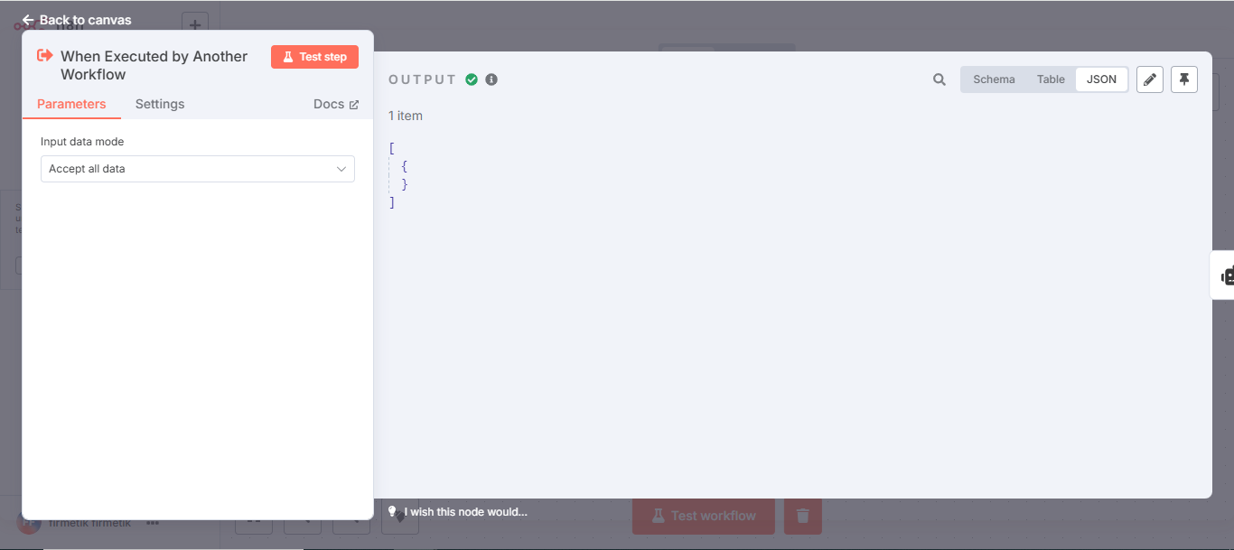

Thanks Samuel all good but the only problem that the main workflow doesnt pass data to the sub-agents workflows
how to make the principal ai agent pass data to the sub-agent to make the full process automated so i dont need to pass parametrs by myself like on the last picture in a way if i remove {“input”:“legorafi.fr”} the automation doesnt happen

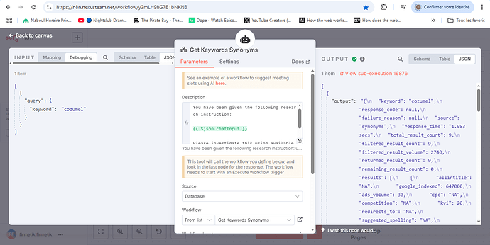

Hey @Chouayb_Attia
I don’t suppose if you put example json to pass in the tool description would it work?
I’ll try look further into it soon otherwise.
