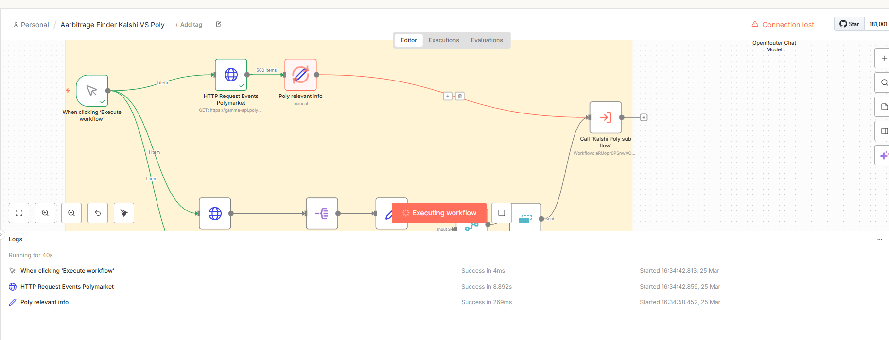

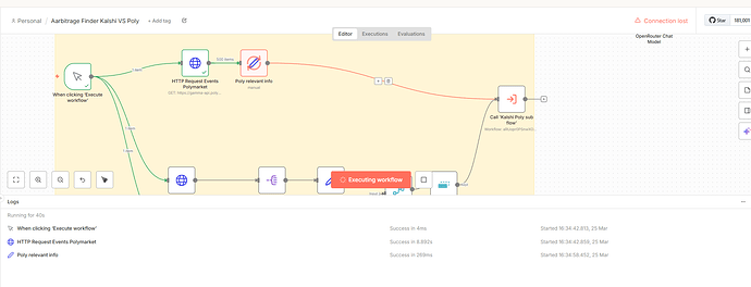

I am using n8n via the n8n cloud, the basic version. I added a photo of crash while working on the workflow
the thing is that the workflow worked before, I downgraded the workflow to make it easier to run so I wont get this message, but it still happens.
@Yogev_Meckler connection lost is a little problem although it mostly occurs when the usage is high, consider upgrading your plan depending on your data processing.

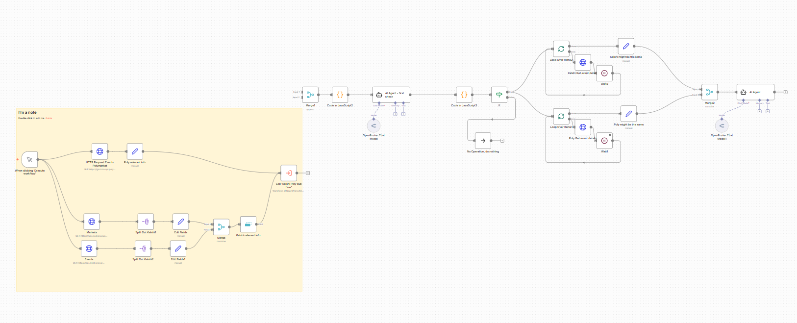

Do you mind sharing your flow here? That would make it much easier for me to debug it.

I am currently using three different APIs, retrieving a large number of items from each (500, 3200, and 3200). I then remove unnecessary data—the raw data is about 10 MB, but I filter it heavily in the following node to avoid overloading the workflow. After that, two AI agents search through the data, which also involves filtering out irrelevant information.
