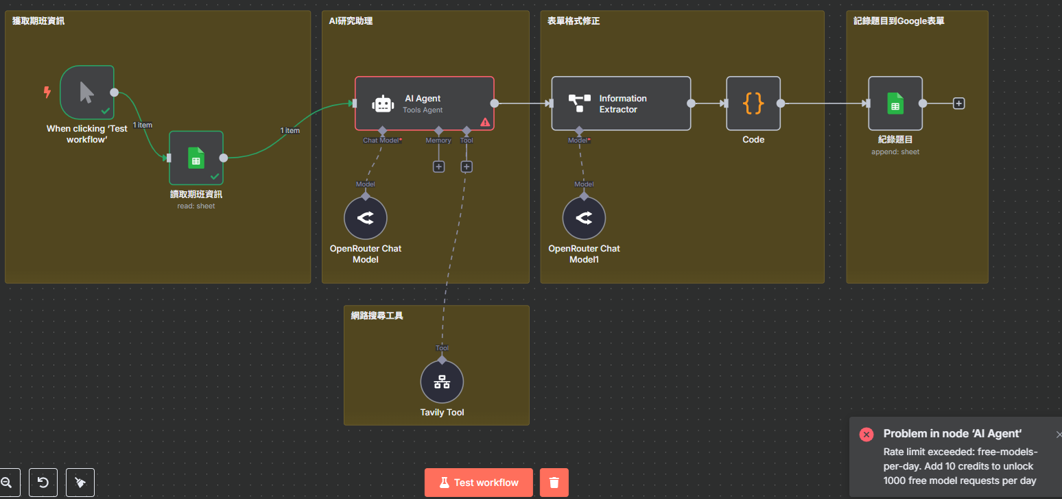

I got Problem in node ‘AI Agent‘ for Rate limit exceeded
I built my n8n project on Koyeb, and got a message: “Problem in node ‘AI Agent’” after using it normally for a while. I’m not using n8n Cloud directly, so the AI Agent shouldn’t require payment. How can I resolve this issue?
Rate limit exceeded: free-models-per-day. Add 10 credits to unlock 1000 free model requests per day

Gallo_AIAMsquare_Automation Thank you very much first. I initially thought that the cloud version of n8n requires payment after the trial period, but that self-hosted n8n can be used for free. So, even if we host the n8n platform ourselves, are there still limitations on the usage of certain nodes?
I believe this is incorrect!
As far as I know, this error:
is not related to the n8n AI features but rather to the model you are using in the AI Agent, which in your case is subject to OpenRouter’s limits:
Sure, this problem is solved. It worked after I applied a new key from another account on OpenRouter. I had mistakenly thought the problem was due to the AI Agent node limitation.
