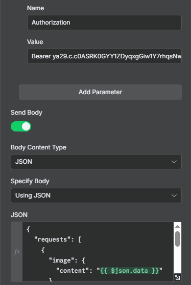

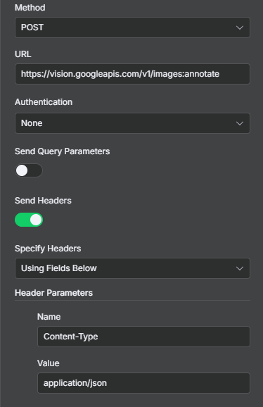

I converted it into a string base 64 after your comment using “Extract from File” Node → Move File to Base64 String
And I edit the “HTTP Request” Node to this form
This should work, right?

Ok great thanks now I have better view. Your request seems to be correct granted the actual image base64 is correct. The pinned data you sent is an incomplete image.
I deleted the rest of the data because the share couldn’t accommodate the full data, exceeding the character limit. So this workflow should work now after the conversion from binary to base64, Right?
I assumed that is the case yes, but dont ask me if it will work, have you actually tried to run it? Are you getting any errors?
All the last errors have been solved, now the error about the billing account so I will contact Google for this, but I want to make sure that everything from n8n side before this
