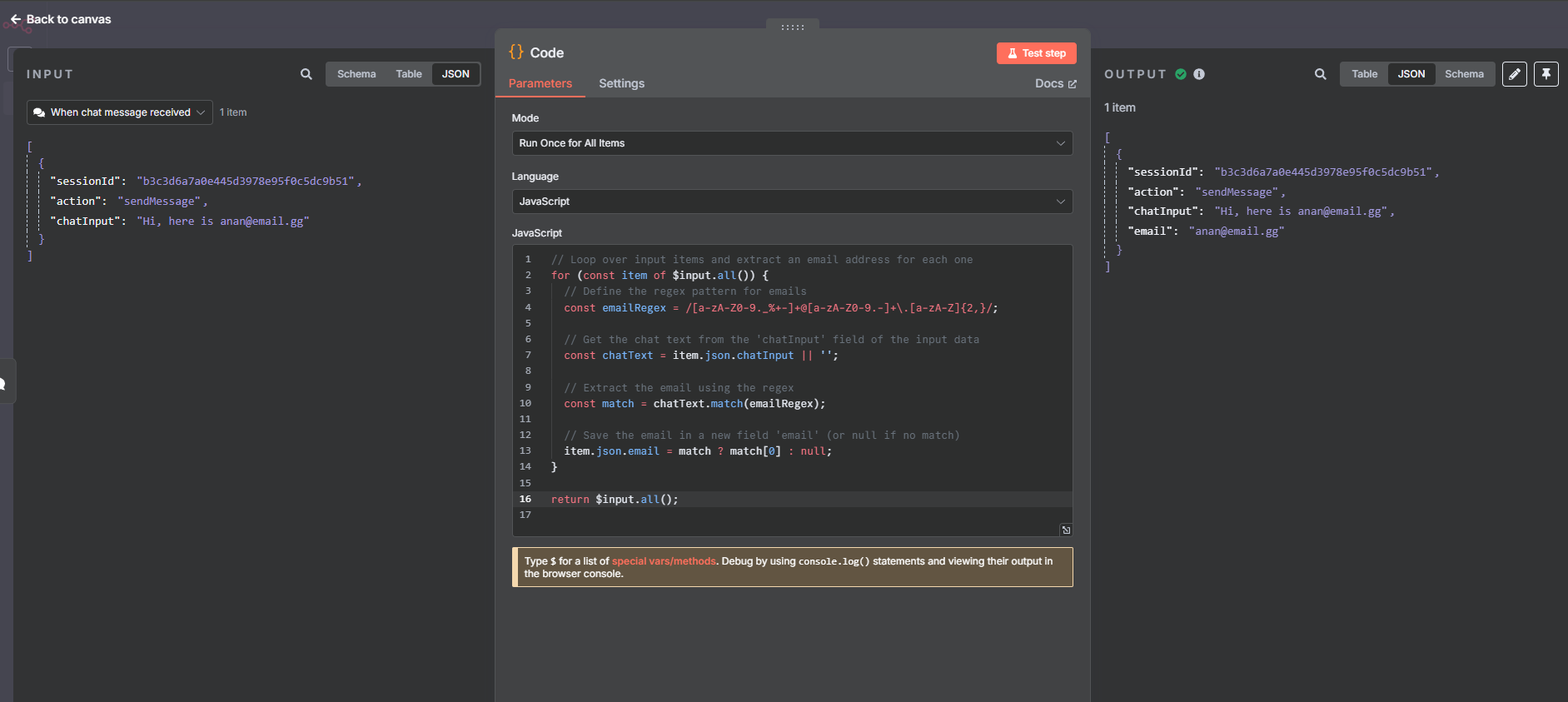

Hi @vball
There are many ways to achieve this. One approach I use to save AI credits is to parse user messages and apply a regex pattern to extract email addresses, For example:
So, in the end, it depends on your actual needs and limitations…

Regex might work but only in certain scenarios since the provided code only works for top level domains with a length of 2 characters (.gg, .at, .de) but would fail with longer TLDs (.com, .net, .shop) since it would only get the first 2 characters after the separator (.)
The code would return something like: “[email protected], [email protected], [email protected]
Really, only the information extractor is gonna help you in your scenario.

This is not true. The {2,} quantifier matches 2 or more occurrences of the preceding subpattern.

Still, double domains like .co.uk arent being catched. Correct me if I am wrong again :wink:

They are. You can easily test this and you should before putting someone’s solution at a doubt publicly. Ignorance or lack of knowledge is not a valid excuse.
