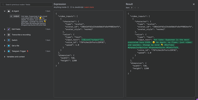

I need your help with this
hey,i think you try to remove the your emojies.
Try
  "video_inputs": [
      "character": {
        "type": "avatar",
        "avatar_id": "28b62dfd2a2346b5bb3fa5e998826ef4",
        "avatar_style": "normal"
      "voice": {
        "type": "text",
        "input_text": {{ JSON.stringify($json["output"]) }},
        "voice_id": "7SFVzXwiSVfnrtc25P3C",
        "speed": 1.0
  "dimension": {
    "width": 720,
    "height": 1280
