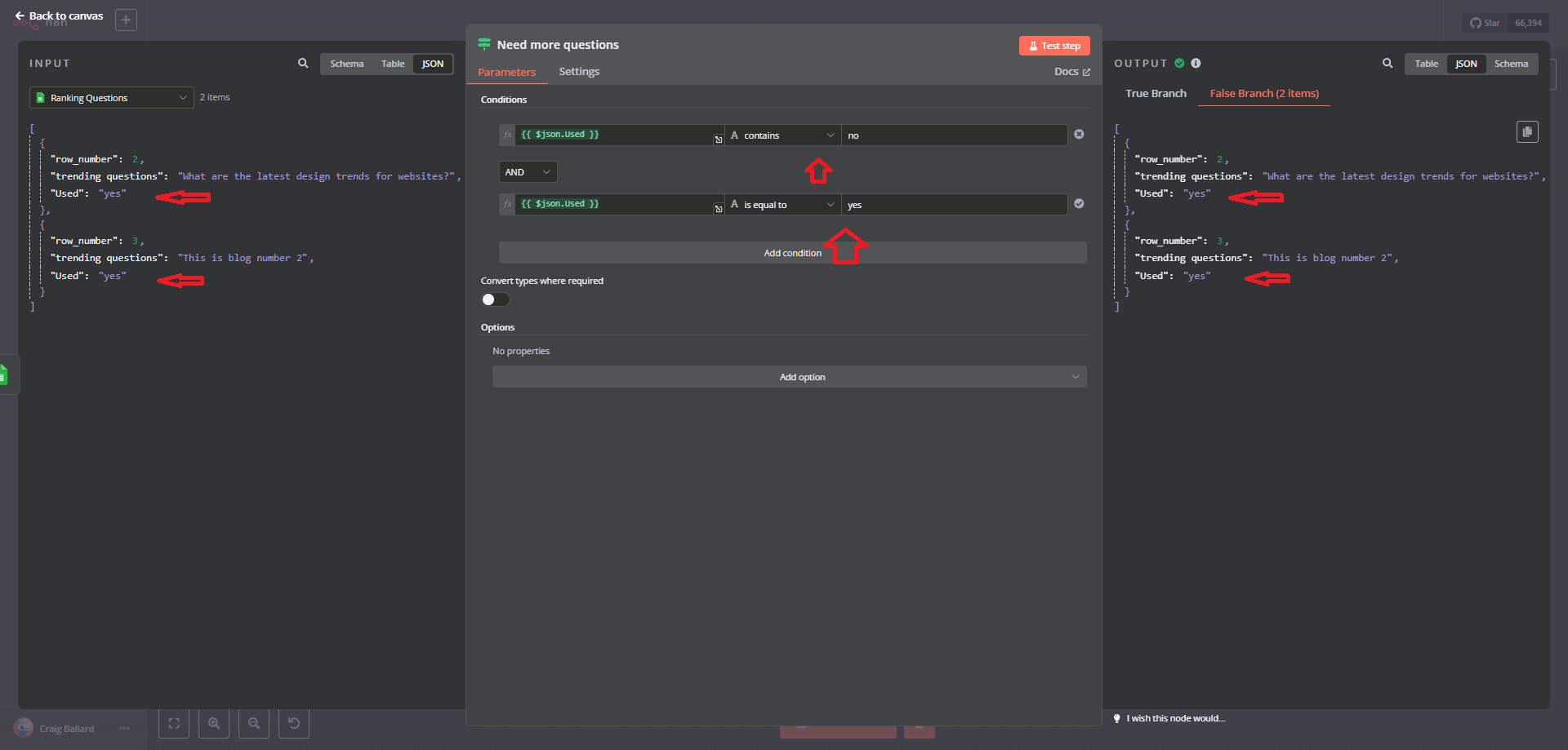

Hi All,
So I am using the IF node to determine whether the statement is true or false.
I am getting data from a google sheet and in one column there is either a yes or no and I want to determine if there is both.
It doesn’t matter how I add the conditions I either get false or I get both True and false.
I thought if I add ‘AND’ then all has to identified to either true or false?

So your confusion is understandable, and is coming from the fact that the output of the previous node is 2 items. Items are “auto iterated”. A sheets node outputting 2 items will pass only 1 item at a time into the next node.
So you are only checking one of the values, not both.
There are ways to solve this tho, could you provide your logical setup JSON in a code block here on the forums to see?

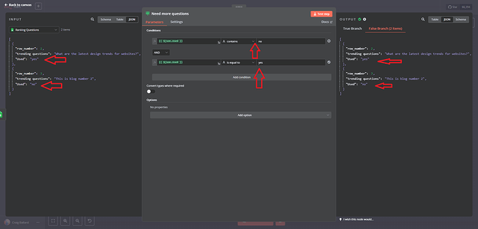

@Craig_Ballard, the expression you used in the condition doesn’t match the provided input, so it will always return false.
To fix this, you can update your expressions:
For the first condition, change it to:
{{ $items.find(item => item.json.used === 'yes')?.json.used }}
And for the second condition, update it to:
{{ $items.find(item => item.json.used === 'no')?.json.used }}
This should give you the correct results based on your input!

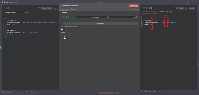

@ThinkBot, @Knight Thanks for the reply.
I want to identify if there is ‘no’ in the column. And I only want a true or false outcome. But I get a true for ‘no’ and false for ‘yes’. @Knight when I update the if node, what do I put in the 3 columns? the fx, condition and the last fx?
@Craig_Ballard can you try this and tell me if it works?
No AND condition. That would be enough to use the true branch for yes, and false branch for no. (Unless you are still having issues)
I am unsure what @Knight is suggesting, as the above should work.
@ThinkBot, I get a true and false,
Is that what you wanted?
So you are checking for no, which output to the true path. And the yes output to the false path. That seems correct?
@ThinkBot, yes that is what I would also except.
However, I only want either a true or false statement and not both. the workflow will then detenand the next step.
The true and the false aren’t happening at the same time. Its iterative. One at a time.
The true branch will continue with the data that is true, and the false branch will continue with the data that is false.
Unless your goal is to check multiple row values at one time, the logic would be different.
