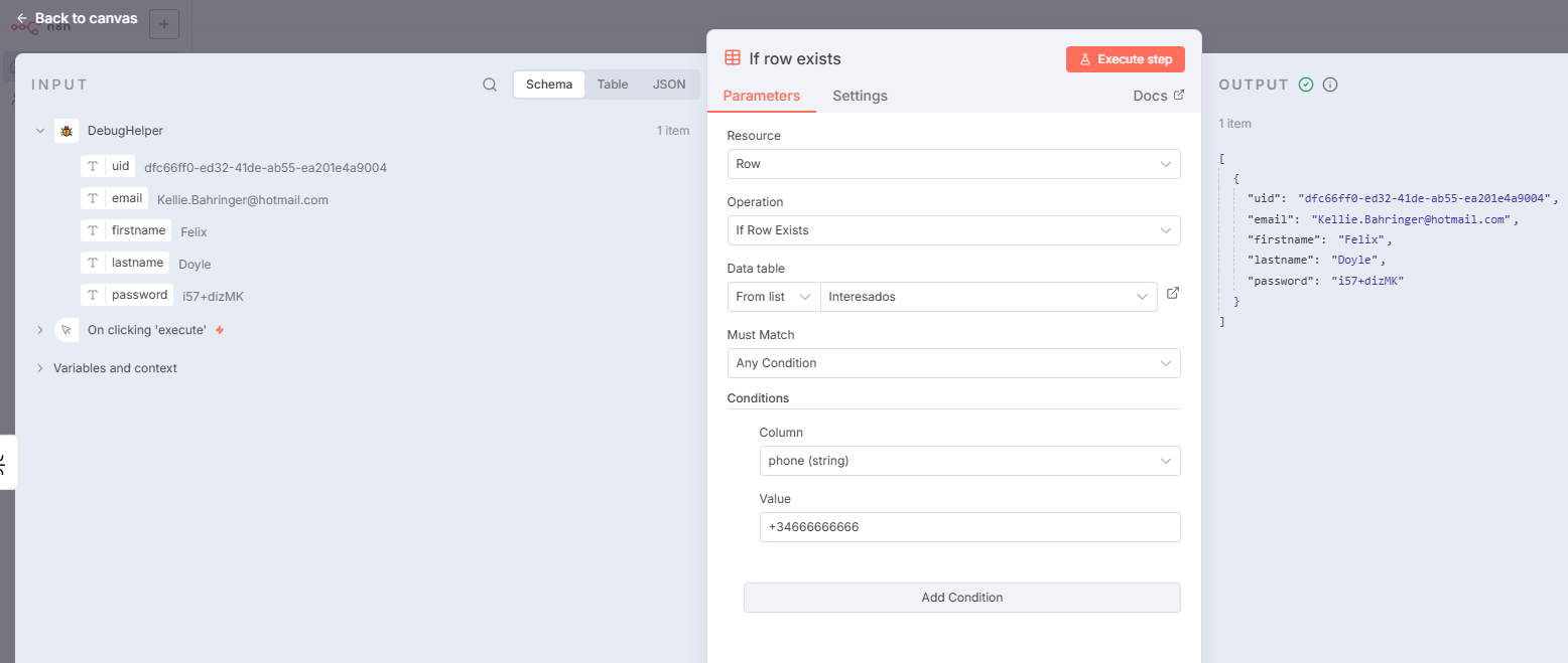

Hey there,
As far as I understand, ‘if row exists’ should return the row if it exists, but in my tests, it returns the output from the preceding node.
I’m quite new to n8n, so it might be just a configuration issue on my side.
In this example, first I generate random data and then check if a row exists. It does exist, but the output is the random data.
Thanks for your help in advance!
Pablo
No error message, the wrong object is returned.
“uid”:
“dfc66ff0-ed32-41de-ab55-ea201e4a9004”,
“email”:
[email protected]”,
“firstname”:
“Felix”,
“lastname”:
“Doyle”,
“password”:
“i57+dizMK”
  • n8n version: 1.120.3
  • Running n8n via: Docker
  • Operating system: Ubuntu 24.04.1 LTS
The documentation is not very clear: Data table | n8n Docs
If that is the intended behaviour, then you need to have a ‘Get rows’ node just before the ‘if row exists’ with almost the same logic, so kind of redundant?
Maybe this is a common n8n pattern I’m not aware of, so would appreciate some clarity.
Thanks!
Pablo
The documentation may not be very clear on this one :grin:
If row exists data table node passes the items it receives if a matching row exists. If the row doesn’t exist, this node won’t output anything. So make sure to toggle on Always Output Data from node settings so your workflow doesn’t stop.
It’s different than other nodes, and its closer to the IF node as it is a statement. You can attach Get row(s) data table node after it if you want to retrieve all values for that row.
