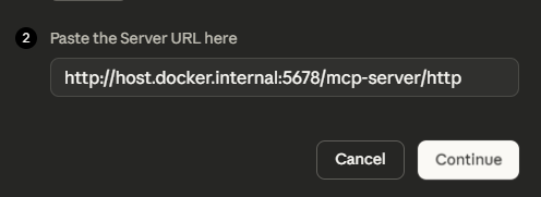

To fix this, you just need to point the MCP server to the “gate” leading back to your machine. If you’re on Windows or Mac, swap localhost for host.docker.internal in your Claude config file. If you’re on Linux, you’ll usually use the bridge IP 172.17.0.1. This tells the MCP container to look outside itself and talk to the n8n instance running on your actual system. Alternatively, just run the MCP server via npx instead of Docker , that way it’s already on your host machine and can “see” localhost without any extra networking.

I solved the problem. I’ve included the Docker Compose installation and Claude config settings below. The Python part is optional; I installed it because I needed it for work.

        "N8N_API_URL=http://host.docker.internal:5678",
