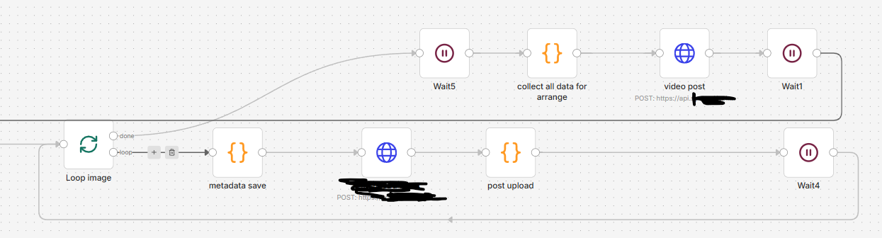

Images upload (references) in random order in n8n — how to preserve sequence?
Hi everyone, I’m using n8n to upload multiple images (references) via an API request. Even though I provide all required fields and build what looks like a correct request, the images end up uploaded and used as references in a random order and the intended sequence breaks. Has anyone seen this behavior before? What could cause the server to reorder files (parallel requests, async processing, missing “position/index” field, etc.)? I’m looking for the best practice in n8n to ensure images are uploaded strictly in the correct order (1, 2, 3, …). Any tips or examples would be appreciated.

I tried every method mentioned (sequential upload, batching, adding an index, etc.), but the system still assigns the images in a random sequence. In my case, the images are used as reference inputs for video generation. I first upload the images, and then I add them as reference website use image’s internal URL (the URL after uploaded into third system ). Even then, the references are attached in a random order.

this is my saving of metadata

Please help me to create post with all images in my positions
this is my workflow scheme, and code was in previous message, what im doing wrong ? Help please.
