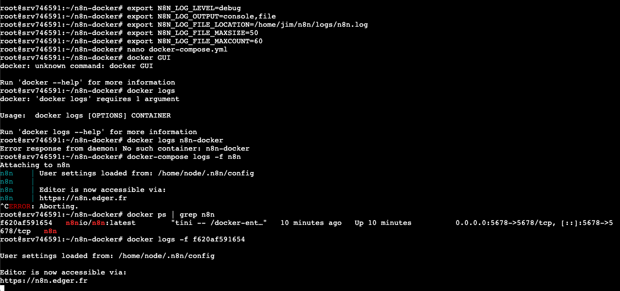

Can you turn on the debug logs and send them when the issue is occuring?
To enable debug logs, please run the docker container with additional ENV variable N8N_LOG_LEVEL=Debug. Then you can see the logs with docker command docker logs container_id/name or via docker GUI
@barn4k
Thanks for your reply!
I’ve edited my docker-compose.yml file (don’t have an .env file).
But then, when I check the logs, I don’t see anything when triggering the email used in the workflow that is currently not working. I’ve tried 4 times, all the emails are marked as ‘SEEN’, but nothing else.
Any clue?
I can’t see any log when triggering the workflow that is working well…
