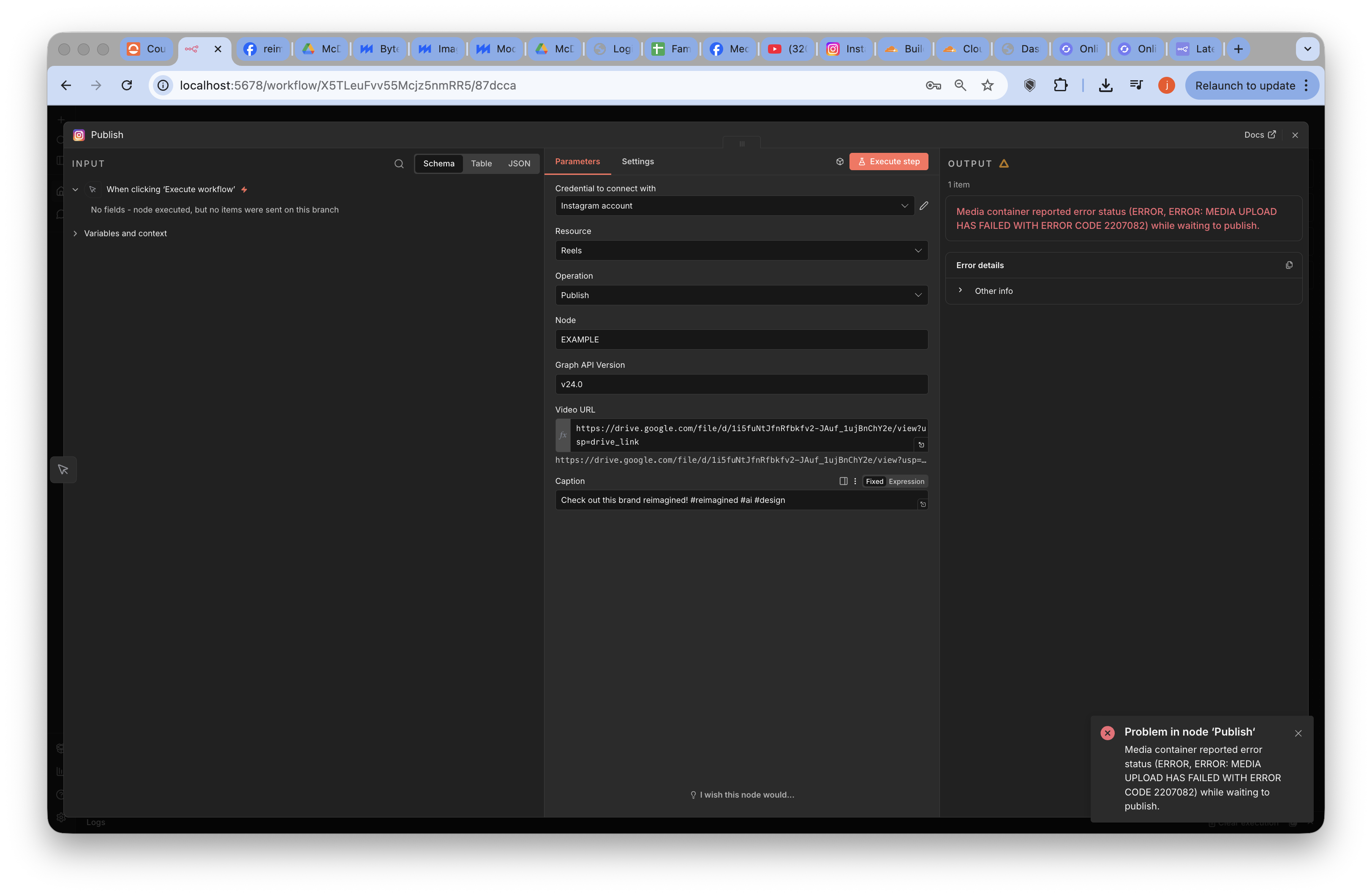

I am trying to upload a reel to instagram using the community note developed for this purpose.
When i send my video url hosted in Drive, i get an error saying Media container reported error status (ERROR, ERROR: MEDIA UPLOAD HAS FAILED WITH ERROR CODE 2207076) while waiting to publish.

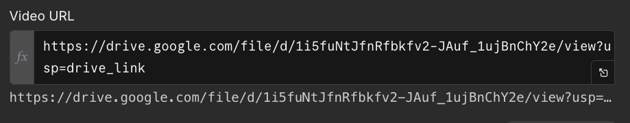

I have no clue why that is, the video is a normal video file in an url like this:
Nevertheless, if i change the format of the video to mov and change encoders, i get this new error:
Media container reported error status (ERROR, ERROR: MEDIA UPLOAD HAS FAILED WITH ERROR CODE 2207082) while waiting to publish.
I only have a trigger now because im testing it.

Is this video URL publicly available for direct download?
Hello! thanks for the fast answer. Yes the entire folder has editing permission to everyone with the link
I don’t think the URL works the way you wrote it in the screenshot, It’s not a direct download link,
Could you try this instead?
https://drive.google.com/uc?export=download&id=1i5fuNtJfnRfbkfv2-JAuf_1ujBnChY2e
