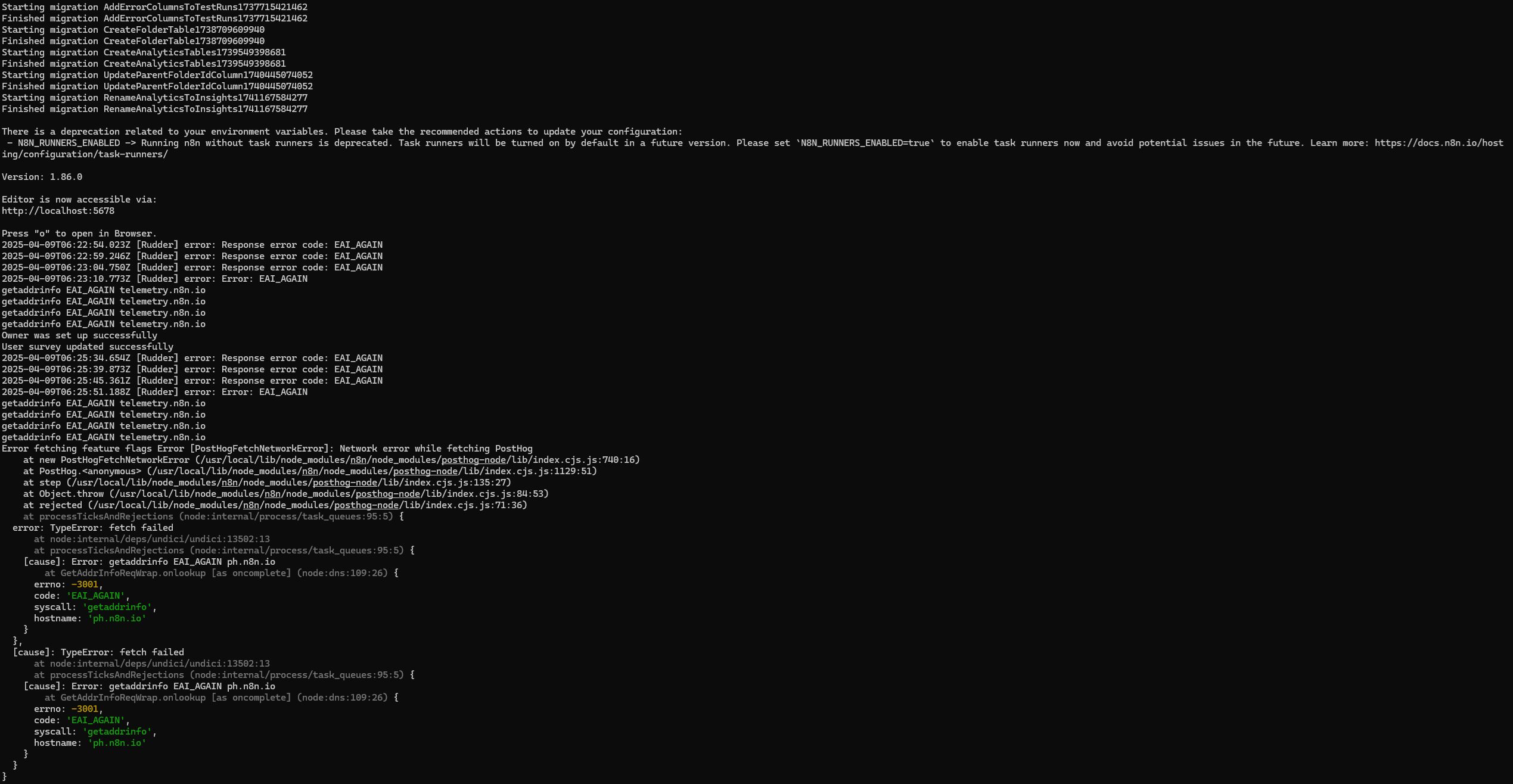

Install n8n docker get error: getaddrinfo EAI_AGAIN ph.n8n.io
After download n8n docker image, got error when running it.
It shows “Error: getaddrinfo EAI_AGAIN ph.n8n.io”, but I can Ping this domain ph.n8n.io.(Work in host env, not work inside of docker)
I restart the docker and even remove all and reinstall it, still not work.
The default web site (http://localhost:5678/variables) I can access but can’t get activation key due to error decribe above.

Yes, it is not only for ph, but also telemetry, enterprise and etc, and continuously.
DNS lookup only work in host for these domain, not work inside of docker
could you try to append --dns 8.8.8.8 to your container start? this is one of the public google DNS servers.

Thank you so much, you save me a lot.
