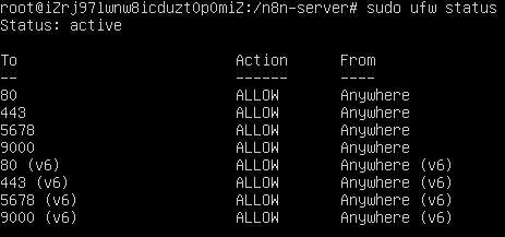

The firewall is as in the printscreen, priority and order, how to see?
Good morning colleagues, I ran a command yesterday that says there is a process using port 5678, could it be when I tried to install it via npm before doing it via docker?
@Afonso_Campos ,
Try to go from scratch , remove everything related to n8n from docker containerx volumes etc and specially the npm installation
I removed npm and the installation is running, can you access the post link to see if it is opening? Please
